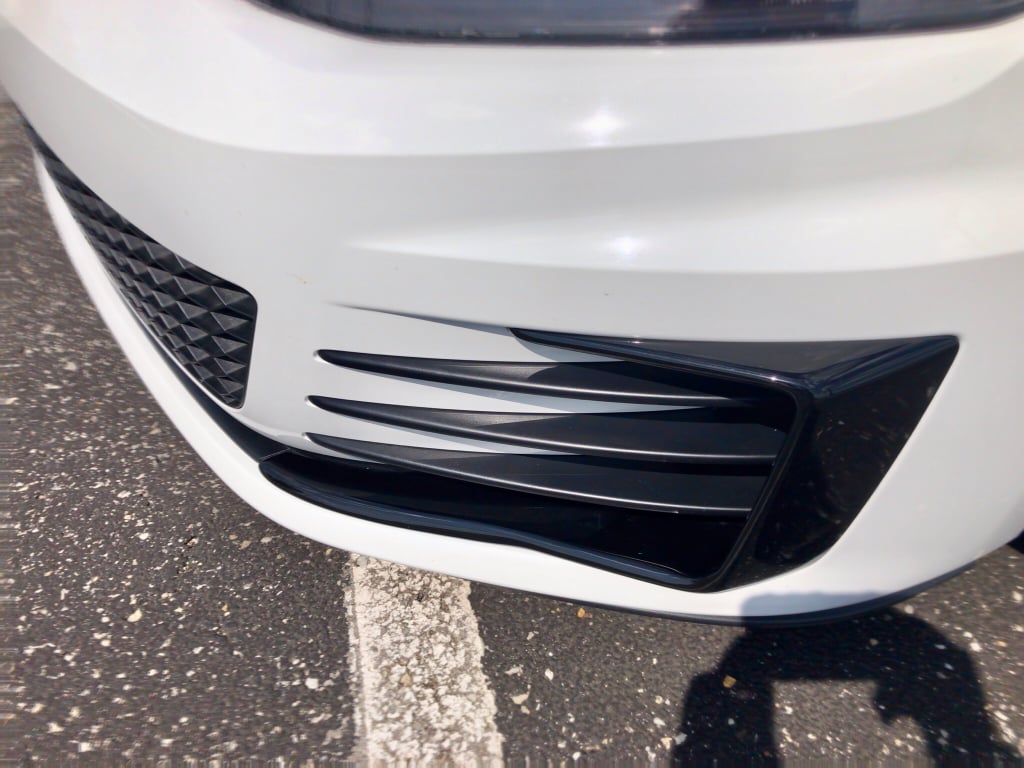

Installed them last week. Wrapped them in Lamin-X clear film this weekend due to them sitting low and likely seeing many rocks.

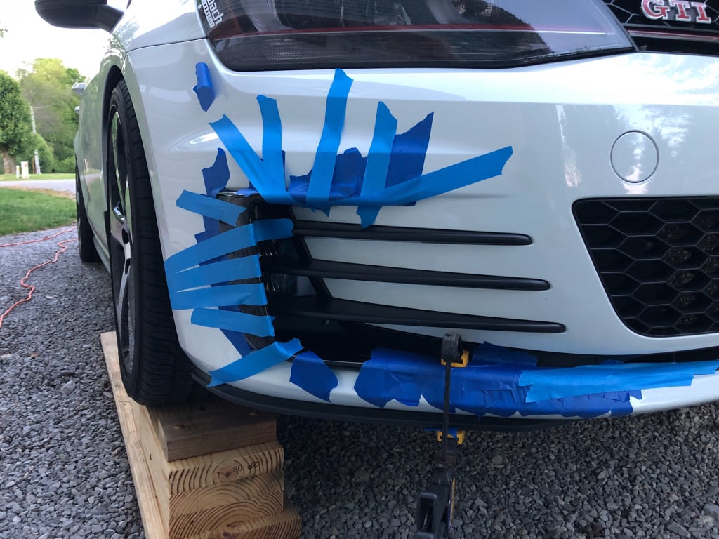

On the passenger side (1st install) I applied a bead of the adhesive to the part a little back from edge all the way around. This worked ok but did have some adhesive push out, which had to be cleaned. I used low oder paint thinner, which works well and cleans complete. Only issue is hard.to hold and clean. If you tape to hold, then harder to clean with tape in way. On the second one (drivers side), I applied adhesive to the part only on the top edge set back some. Please the bottom and back toward the wheel I ran a bead of adhesive along the joint between the white lower bumper and black plastic of the fog light fins. This is the contact point of the SRS piece. This process was cleaner and had less wipe up. The next day you can apply more(sort of like caulking) and smooth out and fill the joint if needed. My driver side did not need any touch up as I used better process and this part fit perfect.

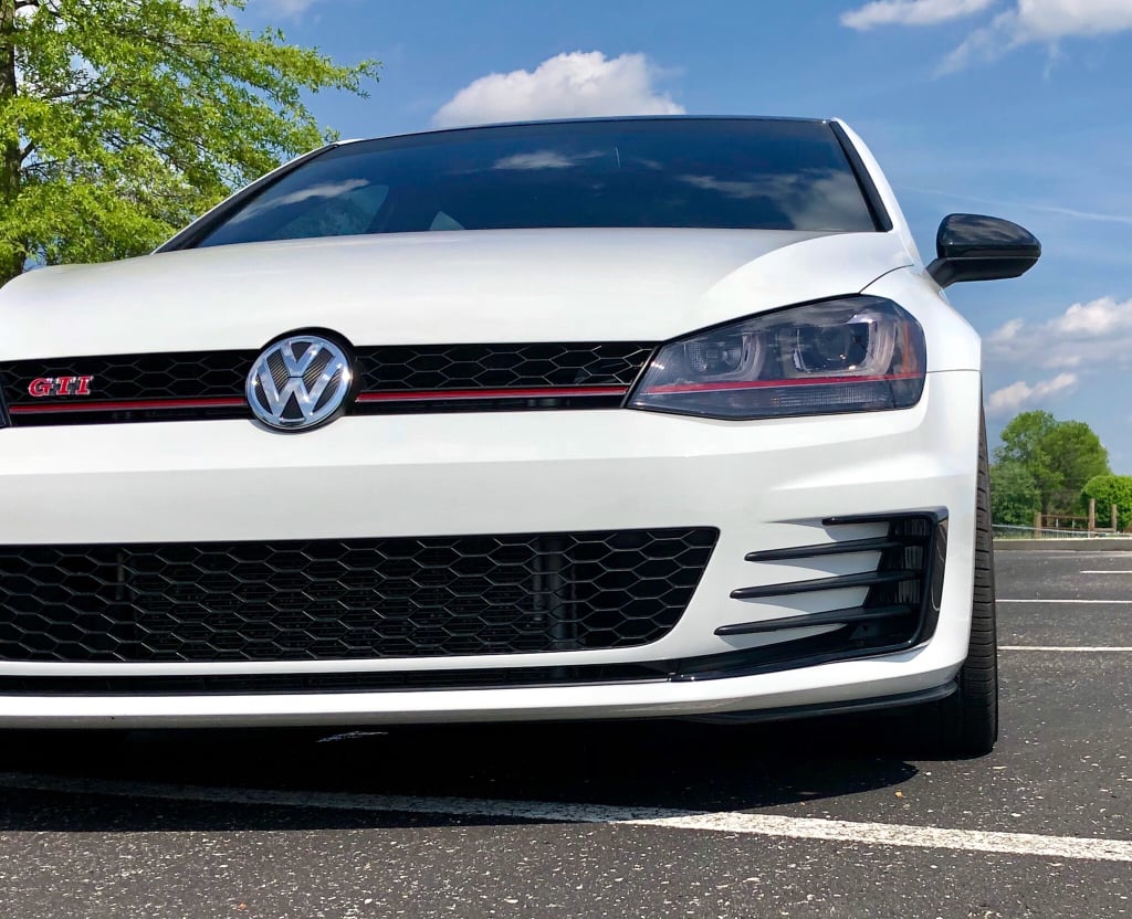

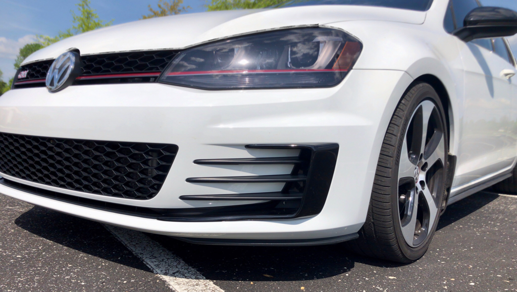

I think it looks good.
The PP package should have had this as an option to set it apart.
I think it looks similar to the Porsche piece. Extra but fits in well.
I added the clear film as I think this piece will see a lot of road dirt and rocks.
