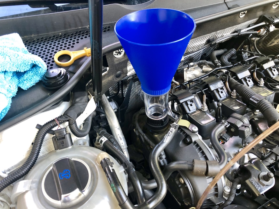

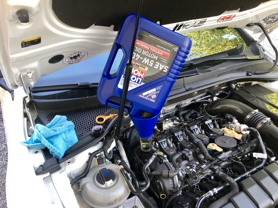

In the interest of not jamming a funnel into the standard fill hole anymore, I picked up a tube extension & cap used on some of the other/newer EA888 motors.
I'm hoping this gives me a nice place to rest the funnel and alleviates the oil weeping from the cap that still occurs even with a "better" gasket placed in the factory cap. The o-ring seal on the extension is large and flat so it should make a solid no-weep seal.
This is a legit OEM VW China part
Apply to Passat B8L Tiguan L Golf 7 MK7 CC EA888 improved oil cap Oil filling port Oil cover 05E 103 485 06K 106 281 https://www.aliexpress.com/item/4000201308010.html?spm=a2g0s.9042311.0.0.67e44c4dVRkBQj
05E 103 485B is the cap
06K 103 281B is the filler tube
