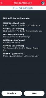

Checked all the fuses, nothing popped, thankfully, got the other lights turned off after turning wheel, lock to lock, EPC and Engine light are still on, I think my scanner can connect to the ecm, but im not sure how to tell. Cleared the codes, and scanned again and didnt get any codes. But car just doesnt wanna start. I attached a screenshot of the codes i got before I cleared them
The CEL will be on in a key on engine off scenario. That is normal. As for comm with the ECM, depending on the scanner, see if it reports back as no codes or if it just doesnt show up. Unfortunately, each vehicle manufacturer and scanner will treat a no comm situation a little different. Some will ignore the module and report nothing, easy to miss. Some will display it retrieved no codes and others yet will be more symptomatic with a major module be off the bus. Make sure your ECM connections are tight as well.

I can go ahead and get a higher end scanner from autozone, there are about 6 or 7 stores where I'm at, so I'm sure one of them will have a scanner that properly connects to the ecm. I only spent $60 on this scanner, and autozone's return policy is pretty good, so I'll see if I can't get a more specified one. The ECM connections I reseated them just to be sure, I'm still getting 0 DTC codes from the scanner, so after clearing them, the scanner is just getting no codes at all.
Then most likely your ECM is fine. The problem is elsewhere. Silly question, have you checked the battery in the remote?
