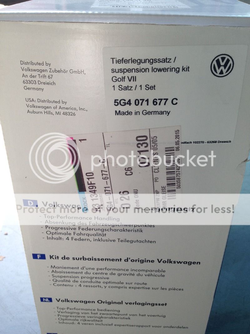

4dr fr 930 rr 890: 5G4 071 677 C

I went to my dealership, parts manager took my Vin, entered it into ETKA and found my car's axle weights. Not permissible load, but weights. He then went to the Zubehör's site and found the set with the closest numbers. Problem was, Zubehör lists per admissible load, not weight.

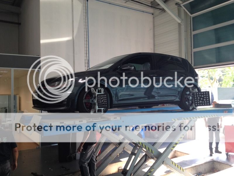

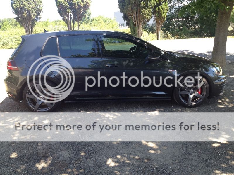

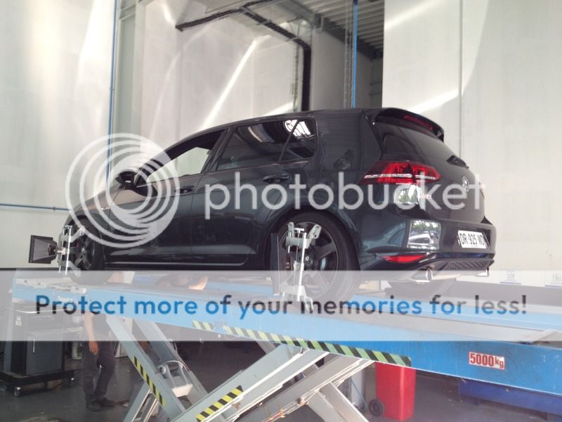

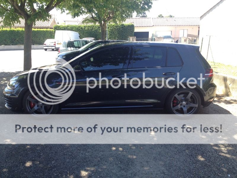

Stupidly, I did not check, so the 5G4 407 677 C set (930/890) was fitted to my car. Result is not good at all: very positive rake (2 finger gap in front, 3 rear), and the front springs simply do not suit my 4dr PP MT6 car. Bumpstops are sollicited way too much, front end feels vague.
Rear feels great, although I do notice the rake dynamically (I am very sensitive to cars' setups but I'm sure most would notice too).
