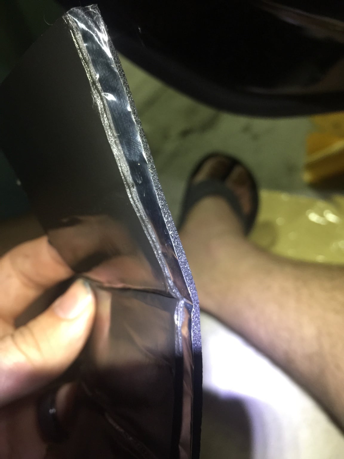

Pic of the high-quality material, which has several layers:

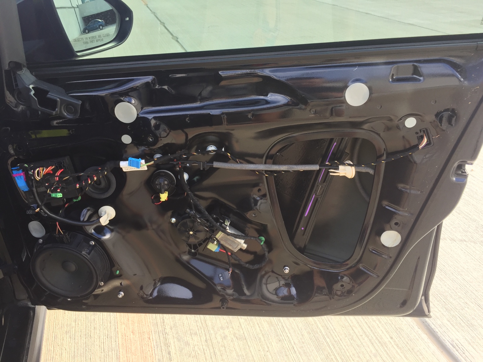

All panels removed:

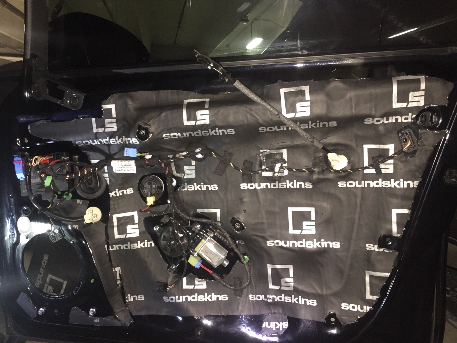

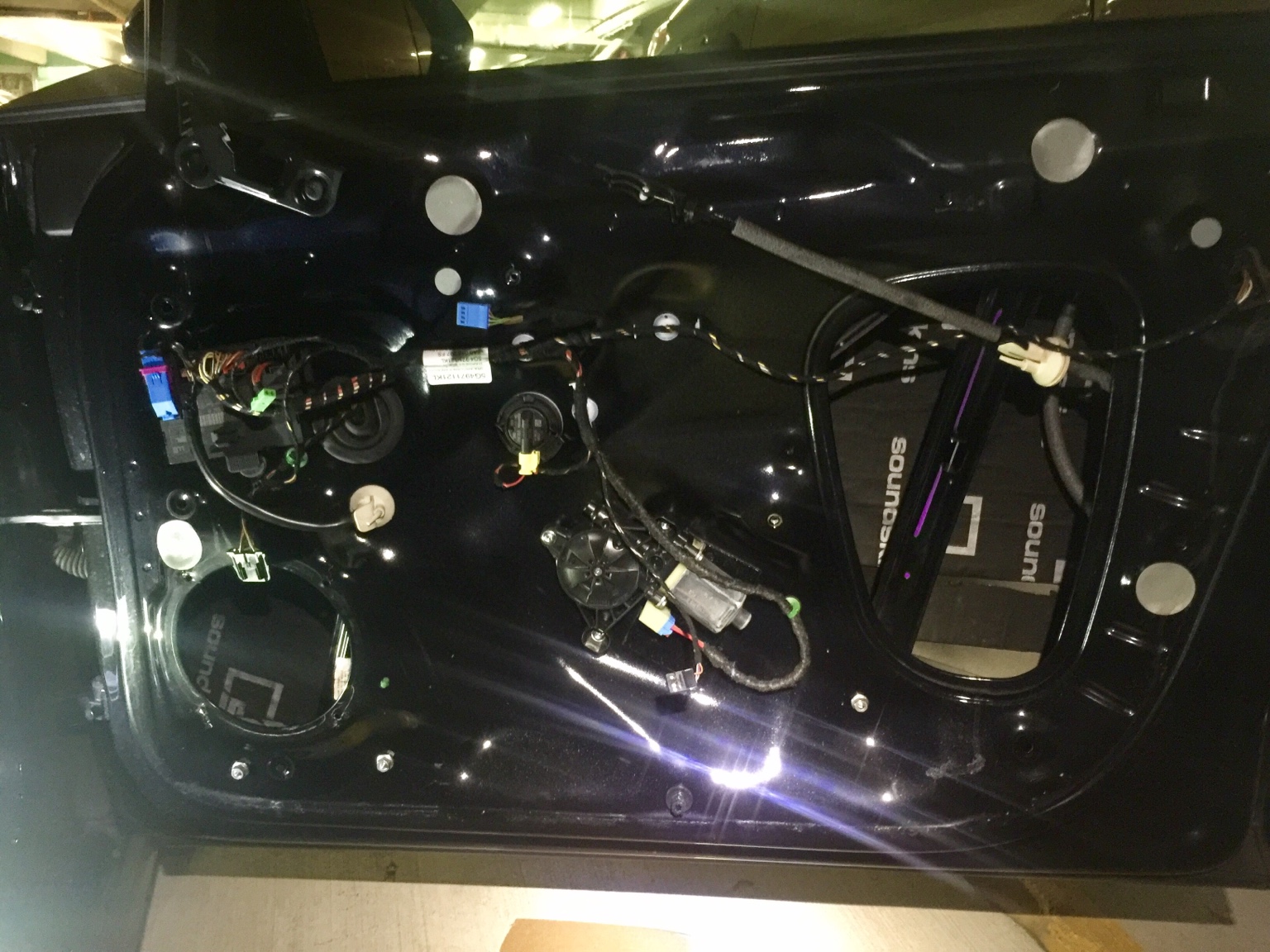

Speaker removed, Soundskins applied to outer shell:
Soundskins completely applied:

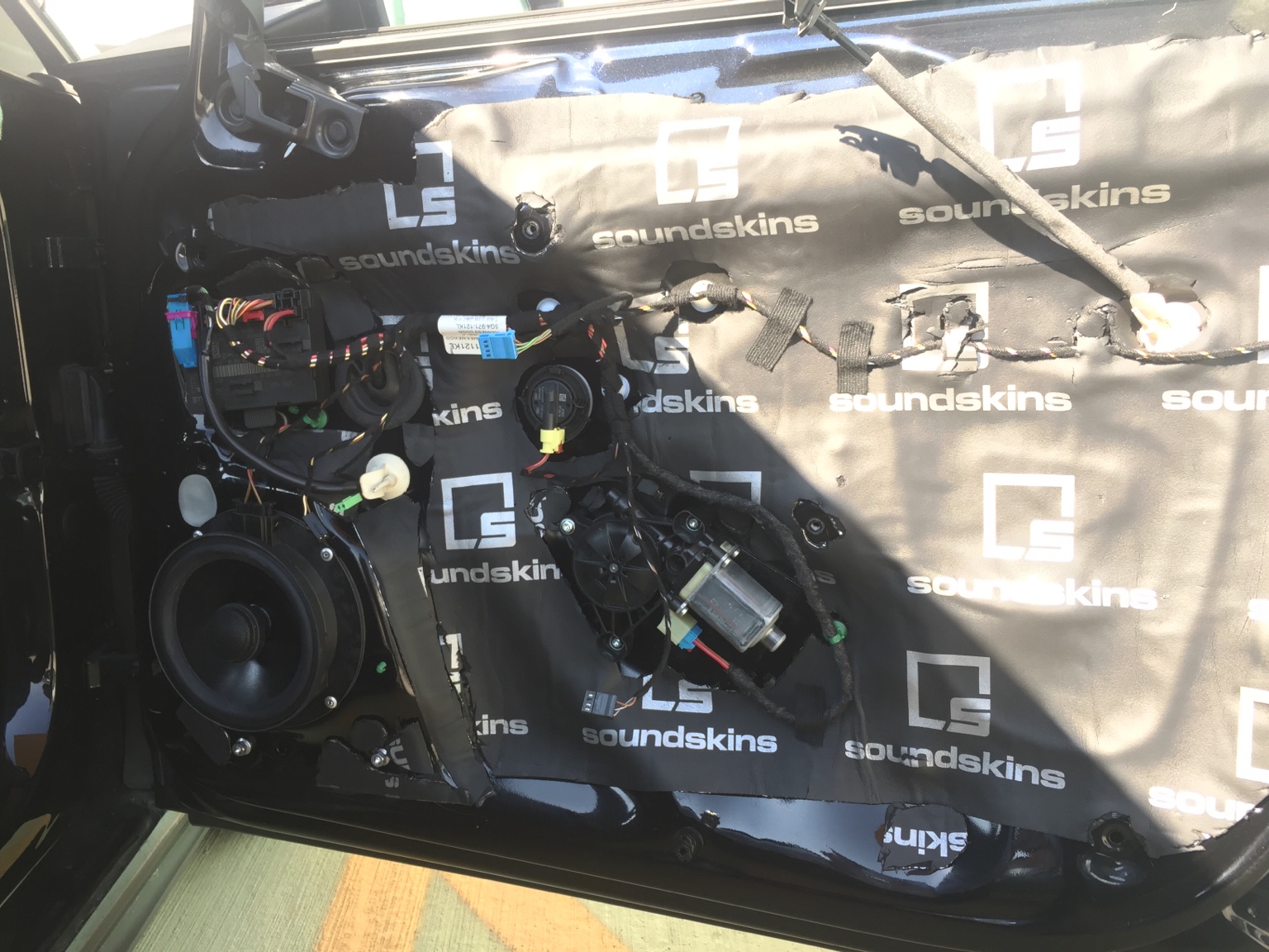

Speaker installed:

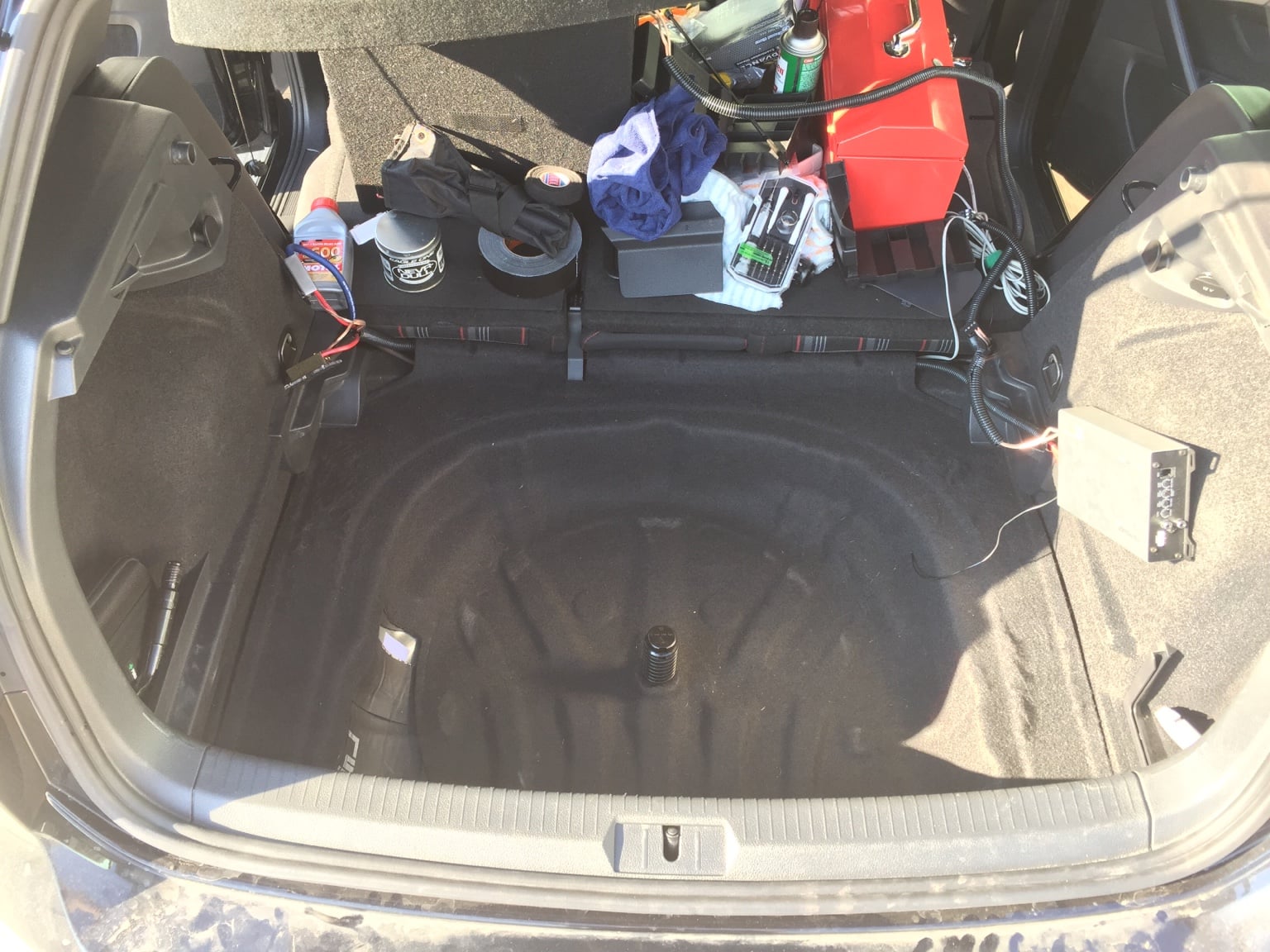

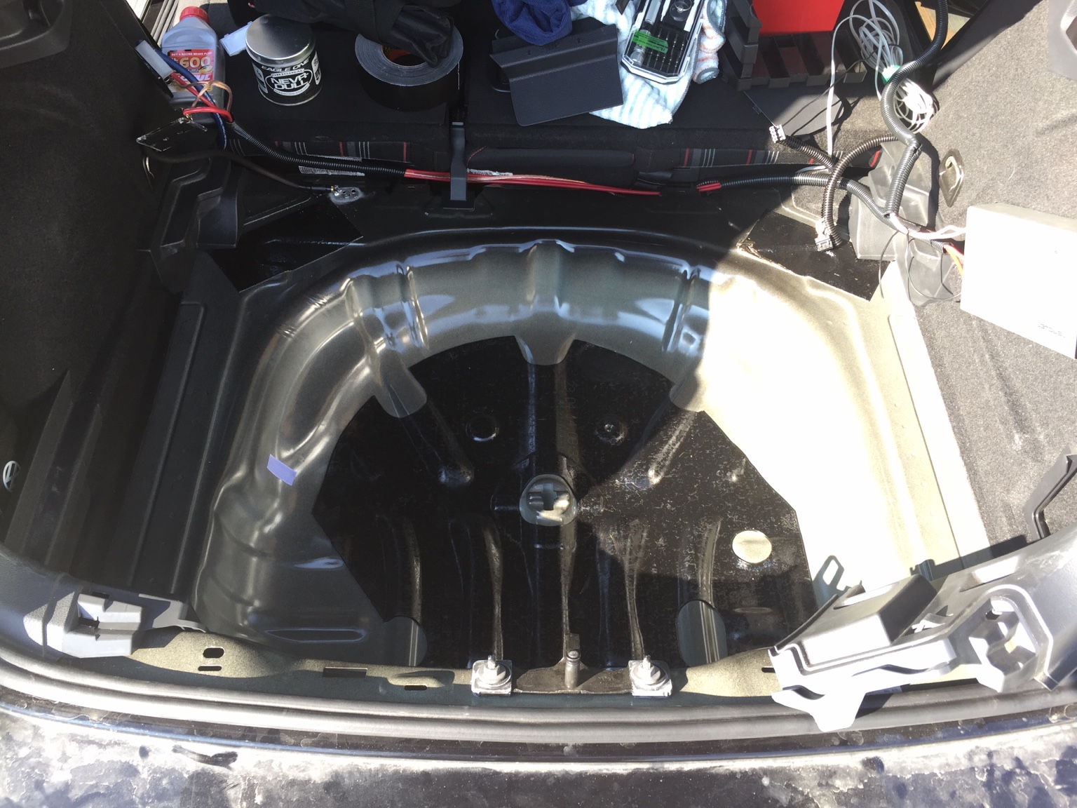

Spare tire area with carpet removed, before (and no, I don't normally keep all this junk back here):

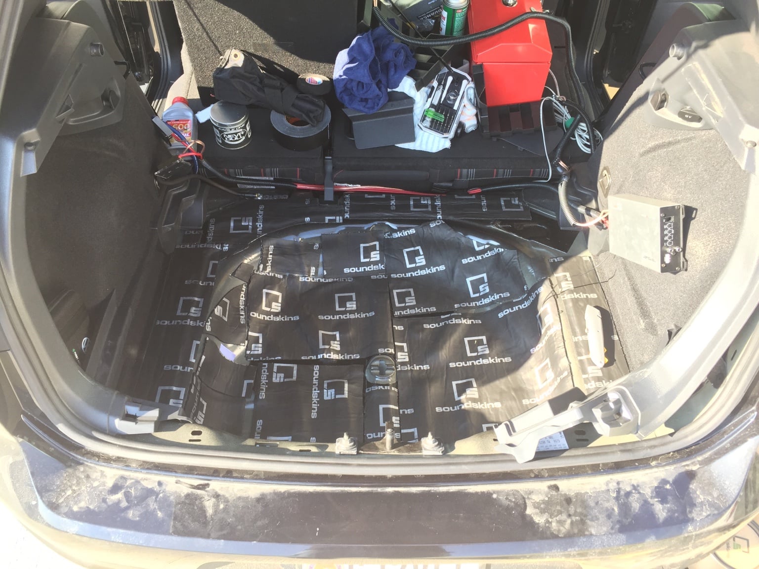

Spare tire area with carpet removed, after (yes I know she needs a bath):

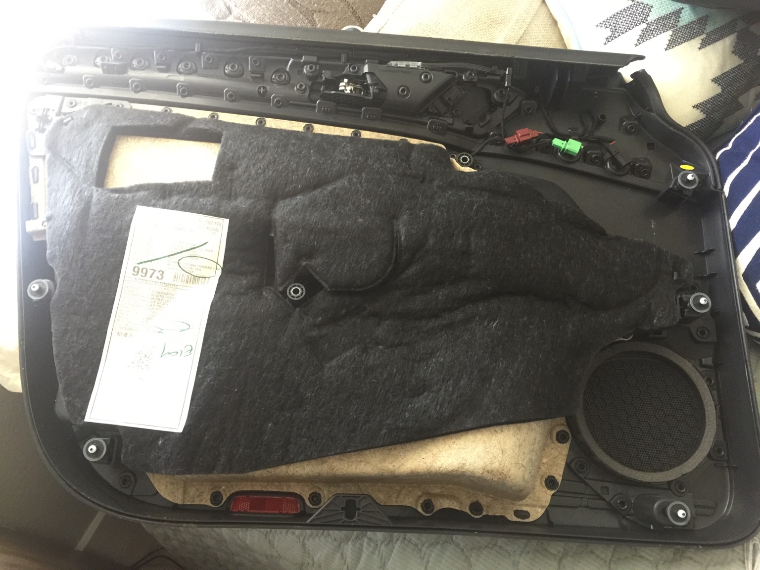

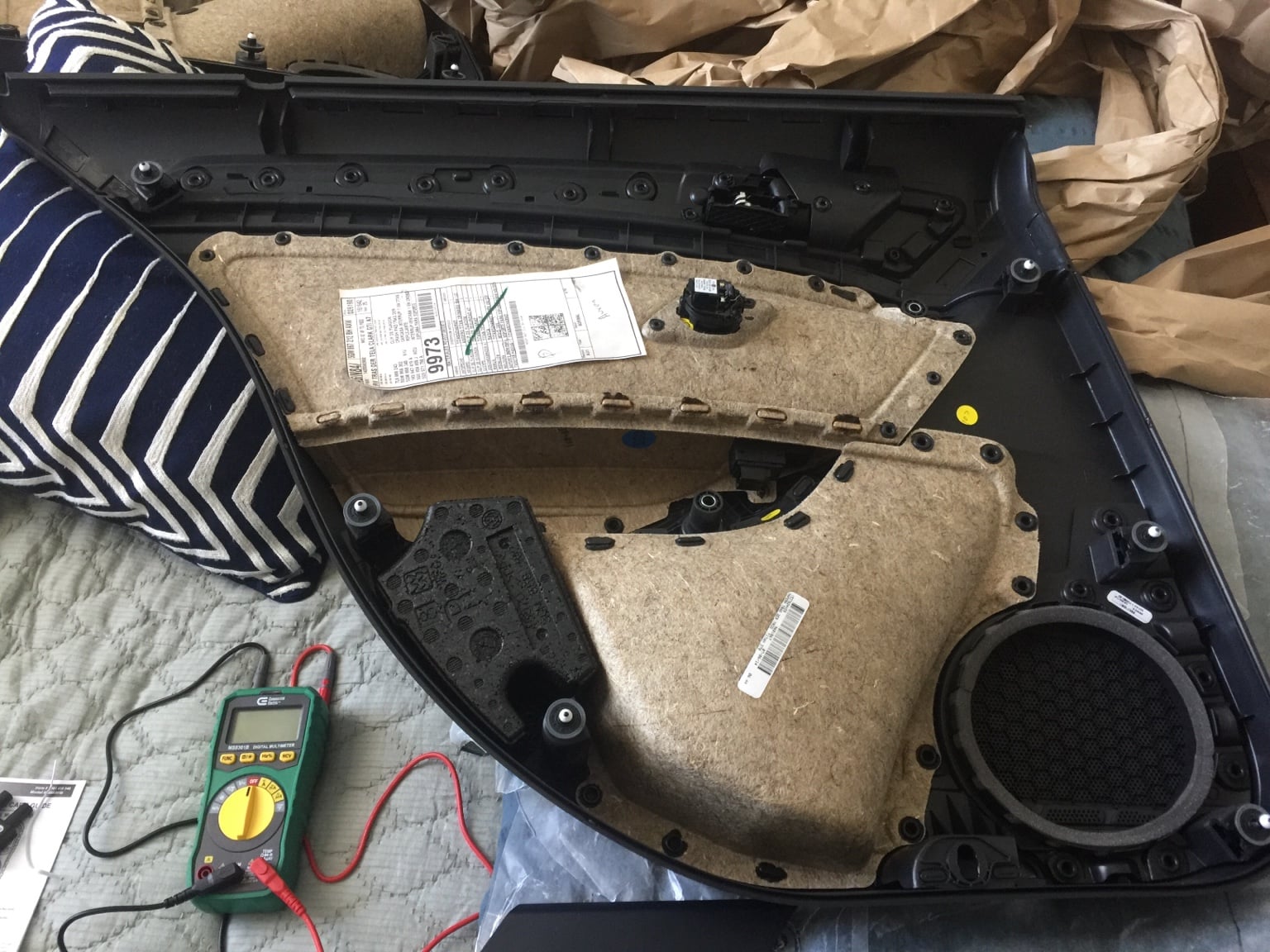

Agreed! I did snag a couple of pictures of the inside of our door panels:
Front doors:
Rear doors:

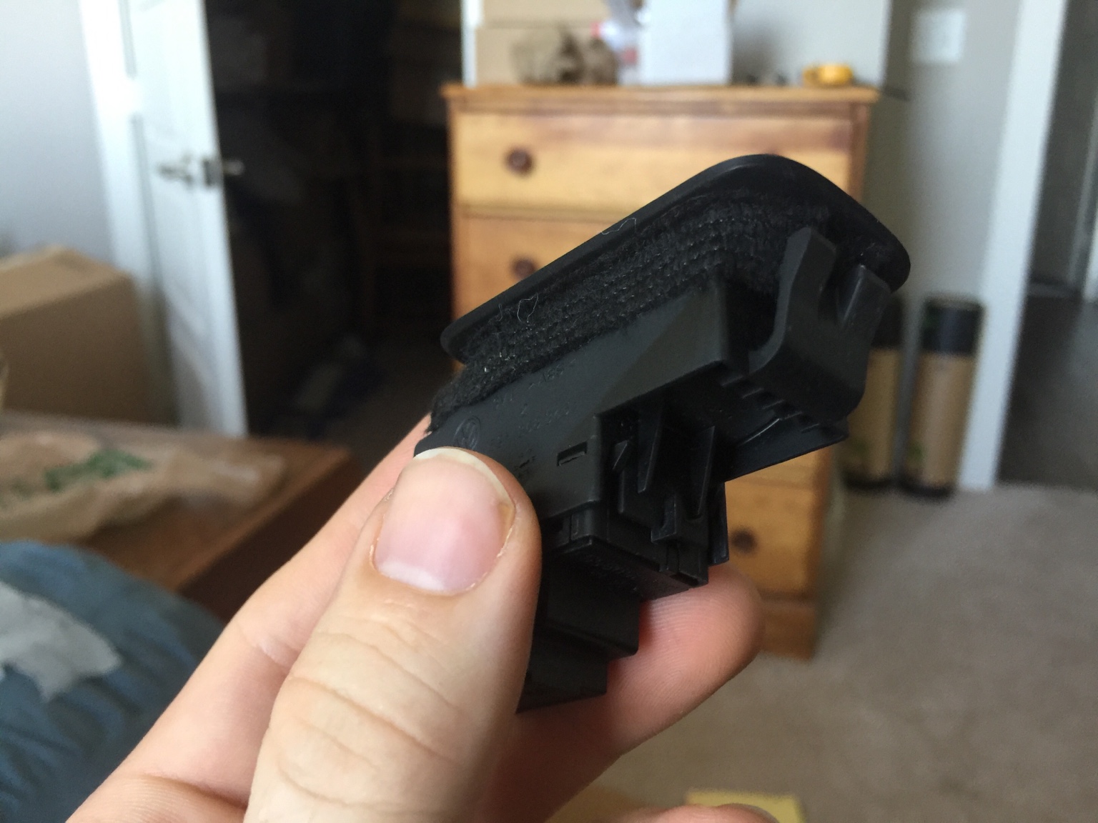

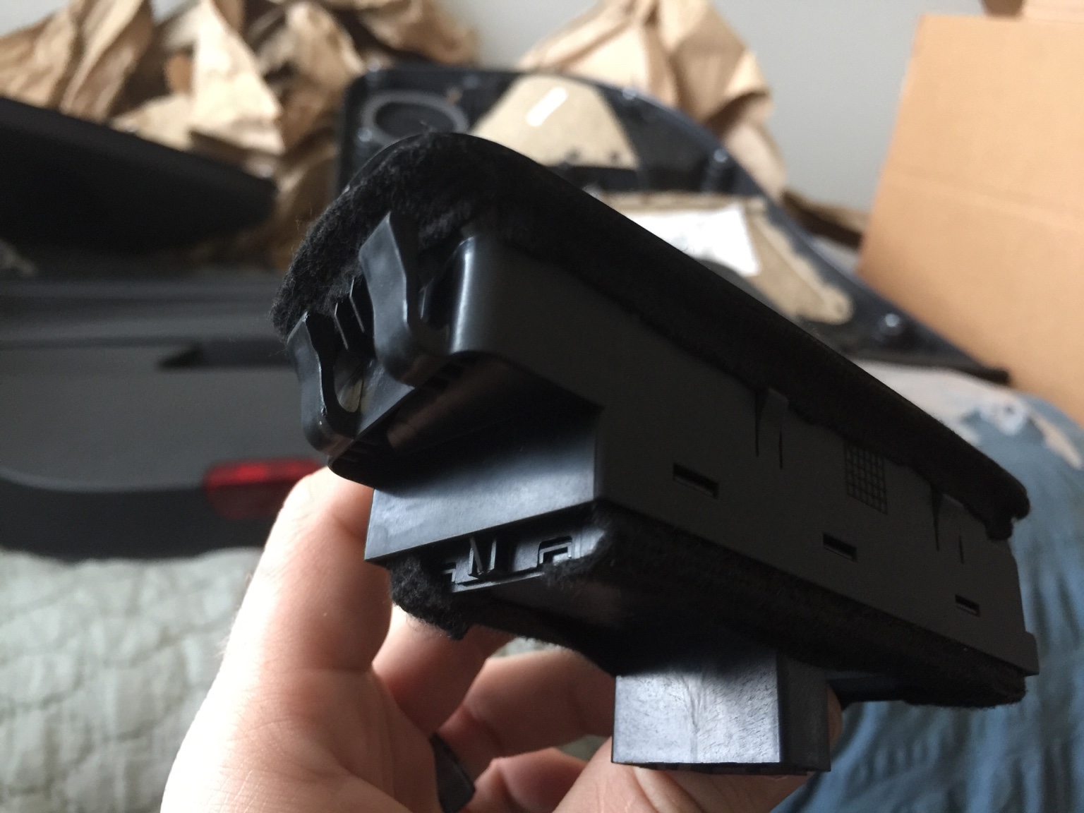

I also took the time to put some tessy tape or whatever it's called on my front door window switches since they like to rattle so much:
Since doing this and the Soundskins, it would seem all of my rattles are gone *knocks on wood*
