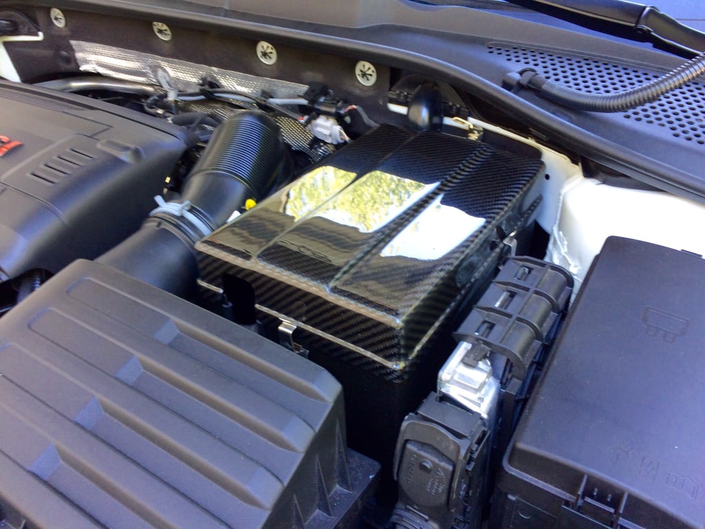

ECS Tuning - Carbon Fiber battery cover with metal box.
After 2 years, decided to do up the battery and replace the felt box.
The fist box from ECS arrived a good while back but the top did not fit the bottom. The metal box was bent a little wide. Also all 3 clips were bolted low on metal box. This meant they did not clip the lid correctly. Called and returned. Ask them to inspect and verify the replacement. 3 weeks later (had to wait for shipment from China). Lid I think is from China as the metal box has info made in Wisconsin town. Guess that is why they did not fit. The second box fit and installed today. I also purchase an insulation jacket the wrap battery to help protect. The ECS box is made from heavy gauge sheet metal with textured finish. CF cap is thick and looks good. For now!

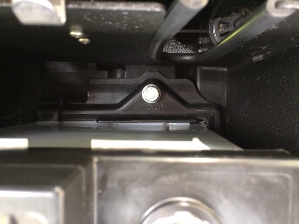

I removed battery to wrap but you can just unhook the two cables, not move battery and slide the box parts in. Two tabs toward driver hold the back in place. A bolt holds the front and uses the bolt location one would use if you purchased a larger battery. The lid slides on while you hold clips back. The box has a front slit for negative cable with room for piggy back module inside for some of you. The box is a little larger than battery. Leaves an air gap at front and along the left side of car toward engine. Right side sits flush.
I like it.
Now we will see how CF holds up in engine bay.
PS. No the OE blanket can not be used also. I think too thick for the right side sitting flush with battery. I did not try but might be tight if it works.

More ECS Tuning Carbon Fiber Battery box pics.
Showing insulation used.
Only issue is the front clip does not fit perfect. The two sides are mounted correctly. What to do. Return again?
I might see if I can raise the clip a little and bolt in place. Hate to spend time returning again. So close.
Now just need fuse box cover. 034 sells a nice one.

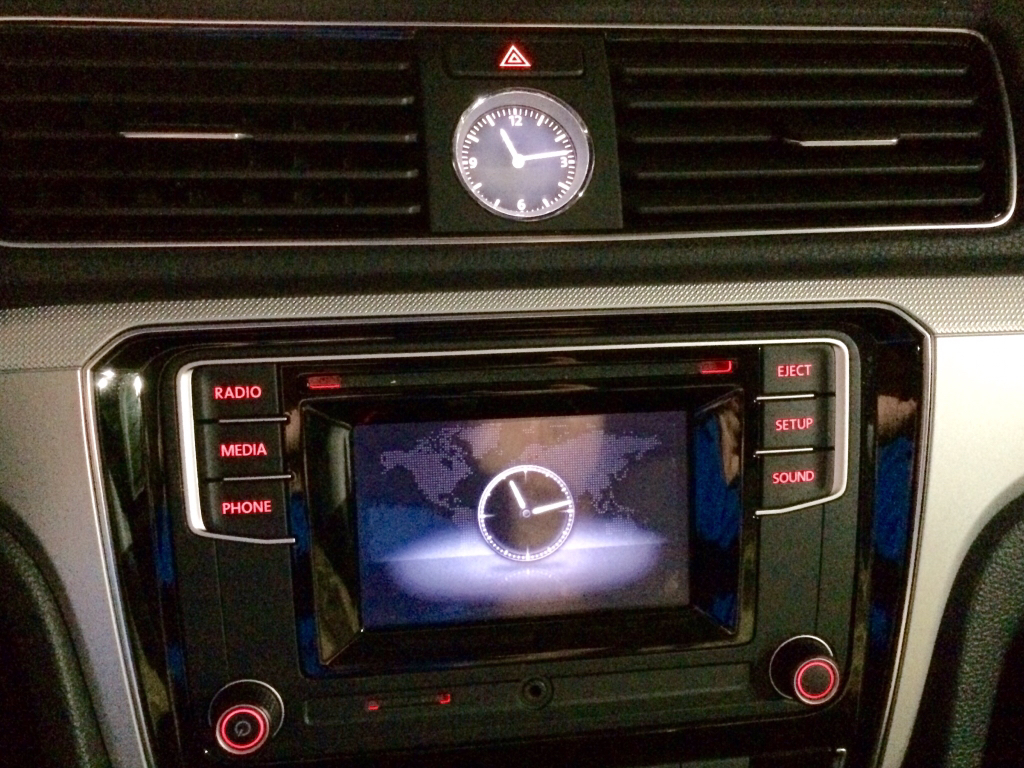

I noticed it has a red ring 12V outlet. I know some have wanted red. I guess check on a Passatt part if interested.
I also find the analog clock on dash a waste. Hard to see unless you are the rear center passenger. If radio off you also now have two analog clocks. Odd.
