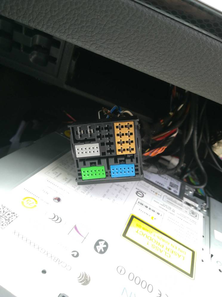

Hi i have a 2012 Golf Mk7 with a speaker problem. My right rear door is dead, i can hear a low buzz from the speakers but no sound. I used the right rear to tap into with my sub woofer install (from behind the HU) and i have no problem with the subwoofer working. So it seems to be ok from the HU and out.
What does the audio signal go via between the HU and speakers?
This is a non Dynaudio car, just standard audio system.
I have removed the subwoofer install, but no change. Wiring behind the HU (aka the cd rom unit).

I did just measure the Ohm in the connectors behind the media unit to measure resistance all the way from the pin to the speakers. All channels had a recistance of 3.8 Ohm. If the speakers is blown wouldnt it be some resistance difference?
Suspecting the media unit to be the problem..
Correct. I suspected the speakers were okay since you get a slight buzzing out of them. Sounds like a blown amp channel from the head unit (media unit).
