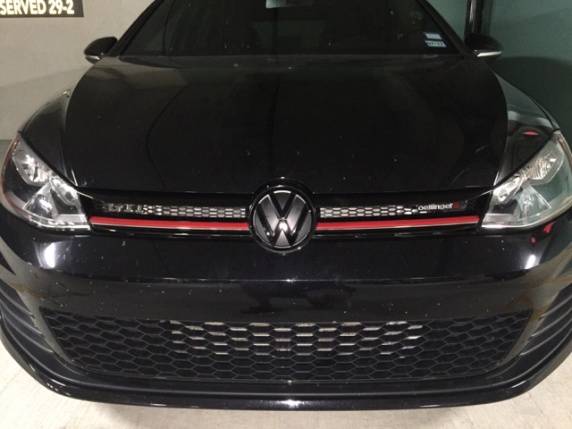

Uhhh what else... Installed an Oettinger grille, I think it looks slick. I went ahead and got it in preparation for matching the red line of the headlights. I put a matte black VW emblem on it and put a badgeskin on it, so the actual V and W are glossy black. I'll attach a better pic when the car is clean :) also put on the rear badgeskin sticker on the rear emblem, and it looks really slick. Waiting for them to come in for the sides, rear and front GTI emblems to complete the look. The only thing is, the front emblem doesn't match since its glossy black VW with matte black outline, while the rear and all other emblems will be glossy black with chrome outline. We'll see once I finish with the emblems and get the headlights installed what I think.

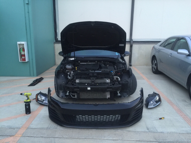

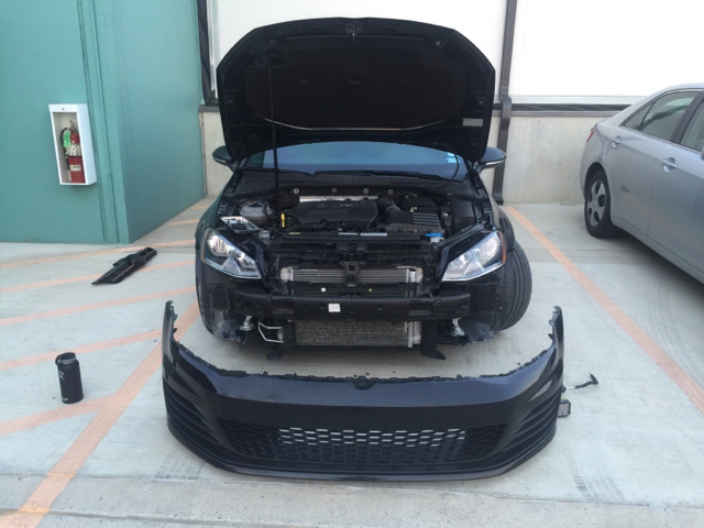

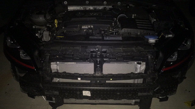

RFB headlights and bulbs are officially installed!! Just did it tonight, man they transform the look of the car.
I started by removing the bumper, which I would later find wasn't necessary, but the DAP vid told me to! [emoji38]
Halogens off!
RFB's on! Out of daylight!!
