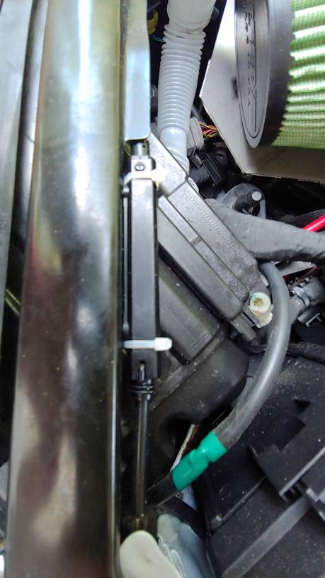

Did the 'mod' earlier today, took about 2 mins. I pinched the end of the (old) middle cable tie using pliers before feeding it through. Don't judge me too harshly on filthy engine bay :)....
