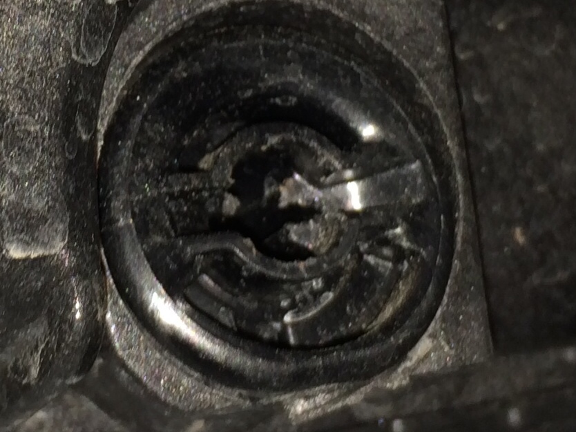

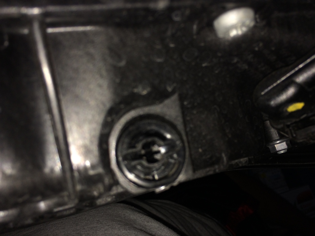

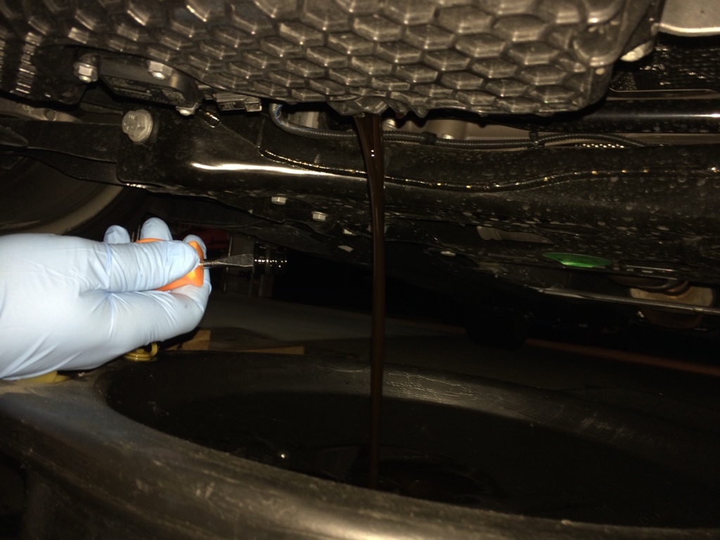

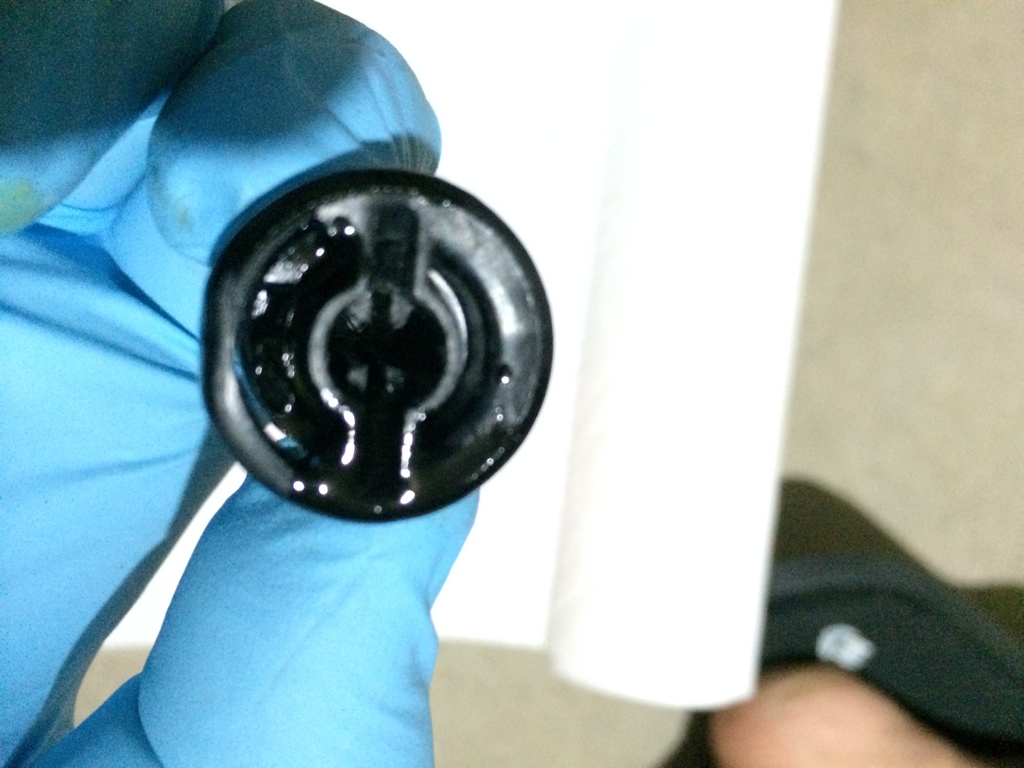

Oil change on R
Bought the items necessary for an oil +filter change.
I must say, very “odd” oil plug made of plastic.
A question. On the oil filter cup it’s printed 25 + 5 NM as torque. Does it mean 25 NM or 30? No big deal but it's made of plastic so I’m a bit cautious.

It means 25Nm with extra 5Nm i.e. 30 Nm max.
As it's O ring sealed and plastic, I'd go with the lower figure.

This is everything I have so far. I want to do a 1,000 mile change tonight. I'm a little worried how tight that filter will be on there.
Shouldn’t be a problem to loosen the filter, just remove the top engine cover, makes it easier ;). Mine was easy done.
The oil plug in plastic could be good to have. FYI - My old one was reusable after remove but since I had a new I used it.
