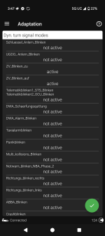

The forum has been a massive help. I do have a question.
Where in adaptation modifies how the tails sweep when locking or unlocking the car?

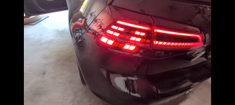

I have a mk7 with the 7.5euro tails and USP harness. Everything works as it should however they do not sweep when locking or unlocking the car.
Using obd 11 i checked "dynamic turns" section and have both "ZV_Blinken_auf" and "ZV_Blinken_zu" already set to "Active". Still only static. flash when locking and unlocking.
ZERO815
Köln Germany
2017 GTI SE DSG
How is Leuchte28 - Lichtfunktion A28 coded in your vehicle?
Whe I changed that function to "Aktive Blinkfunktion hat ein auf 1 gesetztes zugeordnetes Bit in pa_dynamisch_blinken"
Then in dyn. Turn function changed all of these to active:
Dyn. turn signal modes-Richtungs_blinken_linksturn signal leftactive
Dyn. turn signal modes-Richtungs_blinken_rechtsturn signal rightactive
Dyn. turn signal modes-Warnblinken_Zuendung_AUShazards ignition offactive
Dyn. turn signal modes-Warnblinken_Zuendung_EINhazards ignition onactive
Dyn. turn signal modes-ZV_Blinken_aufunlockingactive
I would have sweep functions but the 3rd brake light would also come on...
Dyn. turn signal modes-ZV_Blinken_zulockingactive

I guess the coding of the third brake light is not factory.
However try “Klemme 30G” for Lichtfunktion A28 instead.
Interesting, could be due to one of the apps I uploaded prior. Could be anything from hazard braking 3rd brake pulse or brake flash when locking. Don't remember exactly there were a few I loaded.
@ZERO815 I notice another thing today when the wife was pulling away. The brake lights and running lights are the same brightness. Is there a way to slightly dim the running lights to make the brakes more prominent?
