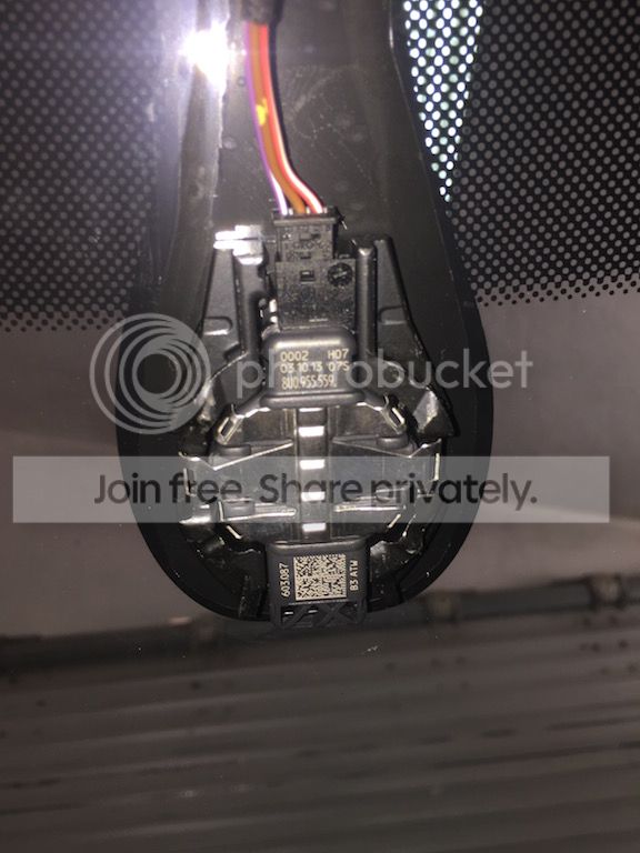

Has anyone retrofitted Light/Rain sensor? My car came only with humidity sensor on the windshield, but I could replace it with light/rain/humidity sensor and install auto headlights switch. Anybody knows what would be next to do/replace?

GolfMNE: Just had a look at the wiring diagram for the rain/light/sensor and guess what? The RLS is a three wire device that looks exactly like the connector in your picture! The wires are:
Red/White = Connected to supply voltage via Fuse 8 on fuse holder C
Purple/White = Connected to the BCM (Pin 28 on Socket C )
Brown =Connected to earth
So, it seems like you have the necessary cabling in place already.
Clearly there would also be some coding/adaptation changes (needs access to a VCDS cable) and you would need to change the rotary light switch, but nothng too complicated.

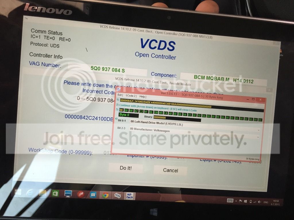

golfNME: i just had a look at the installation process for the sensor - doesn't look difficult as long as the screen is clean and dust free. It appears to be just stuck onto the windscreen by the silicon pad (can be removed and re-installed multiple times according to VW - if the silicon pad is kept clean. There is even an option to repair the silicon pad!
Anyhow, the coding changes shouldn't be that difficult either.
Here's how the new RLFS should be coded:
Here's how the BCM should be coded to recognise the sensor
Here's how the humidity part of the sensor is coded into the BCM ( probably already this way, but worth checking)
If the installation is successful, you should get something looking like this on your auto-scan report :

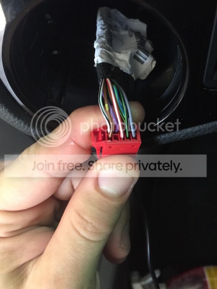

Can someone with factory auto lights and front&rear fogs post a picture of their headlight switch connector. I want to know if mine has all the cables for retrofitting auto lights as I am missing 1 wire.
Mine connector:

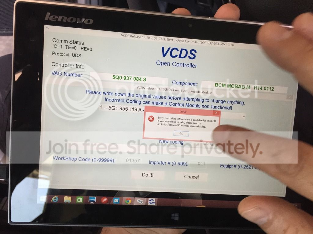

I need help from someone who knows coding!
I installed my rain sensor and switch. I have a problem with coding.
Can anyone write step by step coding instruction. I don't know hot get to menu that DV52 posted.
My friend tried to code it but didn't make it:

Yes, done it few months ago and it's working. All you need is light sensor (you need to have factory fitted humidity sensor for climatronic), auto switch and coding (DV52 posted it above).
I read on other forum that Golfs from 2014-onwards don't have wire for auto lights from bcm to headlight switch, so that could be a problem if your car is made in 2014/15. You can check by looking at headlight switch connector (red color from picture above). If you have 9 wires like mine, auto lights will work.
