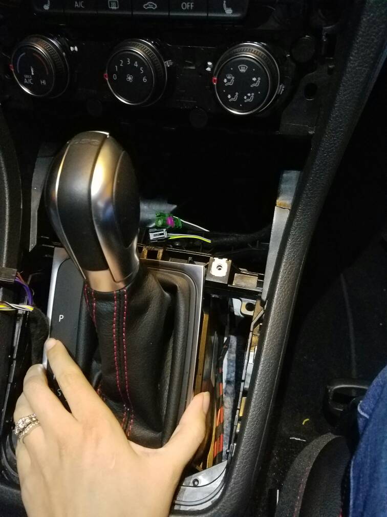

Still stuck on how to get the trim around the shifter out, and the cubby door.
Figured out the trim part yet? Pull up from the back, be gentle though. I broke a clip in mine accidentally when I was trying to dial in my short shifter.
murtaza911
Ontario Canada
I did.
But you can't just pull it out, you can only get the shift boot or this way.
You need to take the cubby out (it just pulls out with a bit of force. May need a pry tool to get it off)
Then there are 2 Tory screws which you need to loosen. At this point the trim around the shifter just lifts out easily.

How did you remove the trim around the shifter? This is the one piece I couldn't figure out how to remove. Oh and also the trim around the gauges? (Can't figure out how to separate it from the entire piece, circles and all, that pulls out)
I just got done removing most of my interior trim. The trim around the shifter clips off after you unscrew the 2 screws under the cubby in the 1st pic...you get to them after taking out the rubber insert in the cubby and removing it...i used lockwire to pull it out...2nd pic..srry if I'm not giving clear instructions, its not one of my suits....the gauge cluster silver trim is heat welded...ive taken them apart in my dart. Easy to do with a dremel but you have to either glue it back on or reheat weld it...hopefully i helped a little
