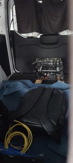

Got the block dropped off. The machine shop said the damage does not look too bad. Waiting for a call back to confirm bore size after cleaning.
