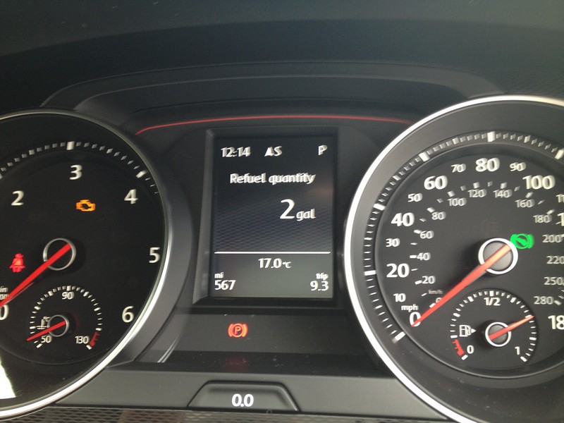

1. Amount of fuel (in Gallons) used since the last fill up
Go into [17] Instruments
Long Coding - (Function 07)
Go to Byte 10
Enable bit 4

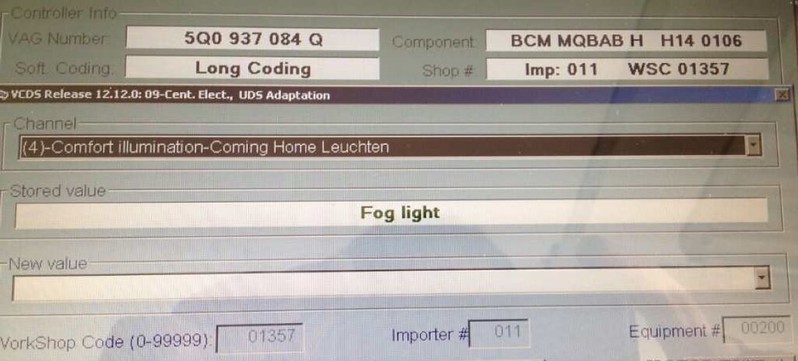

4. Setting Fog Lights as Coming/Leaving Home
Go into [09] Central Electronics
Go into Security Access and enter 31347
Look for the German text under "Comfort-Illumination"
Set the new value drop down to "Fog Light"

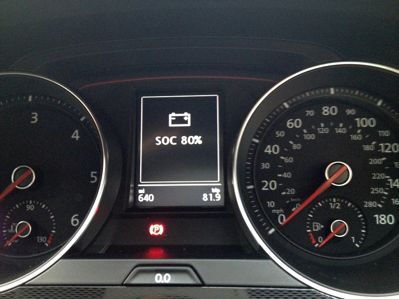

5. Display the battery charge level or SOC (state of Charge)
Enter [17] Instruments
Go to adaptation channels, (no need for a security log in with this module)
Scroll down until you see Battery Charge > simply change it in the new value drop down to "active" and it's done.
Usage
Switch the ignition off, then press (and continue to hold) the trip reset button in the middle lower of the instrument panel. It will cycle from first resetting the trip to 0 miles > show "Time" to allow you to change the clock > then keep holding until say "Battery".
Release the button and display SOC for a few seconds before returning back to the main screen.

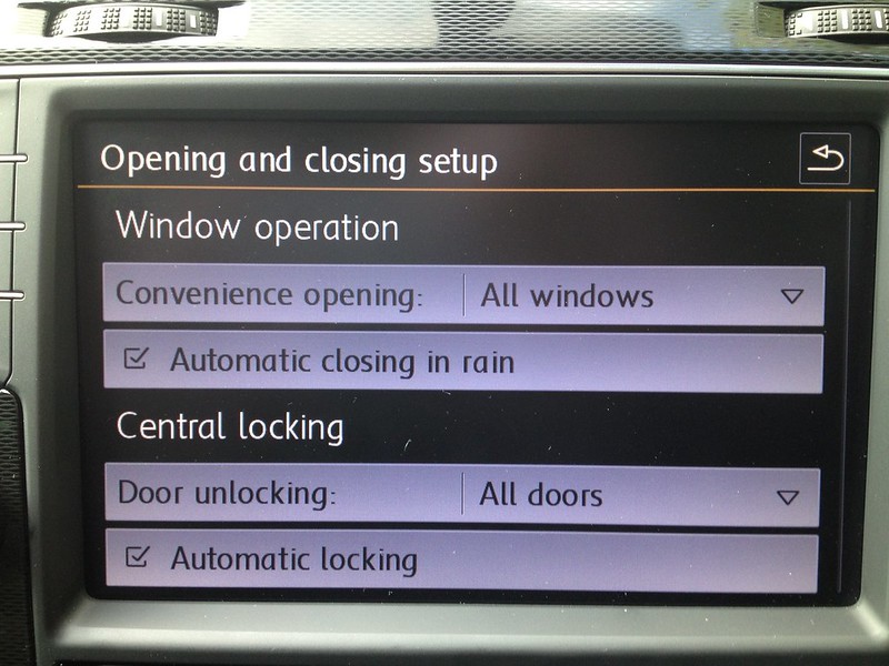

6. Automatic rain closing
Go into Secuity Access and enter 31347
Go to adaptation channels and set the following:
- (15) Access Control 2 - Regenschliessen_ein aus (Rain Closing on / off) - Select Active
- (16) Access Control 2 - Regenschliessen_art (Rain closing Type) set to Permanent
- (28) Access Control 2 - Menuesteuerung Regenschliessen (Menu Control Rain close) – Set to Active (enables the menu in the ifotainment screen)

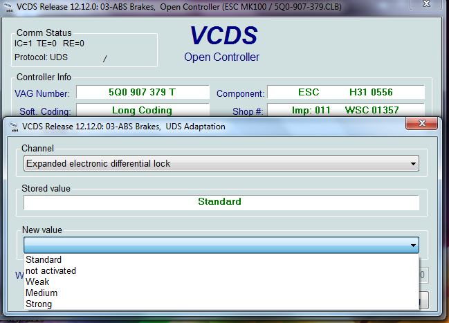

10. Change XDS interaction to strong

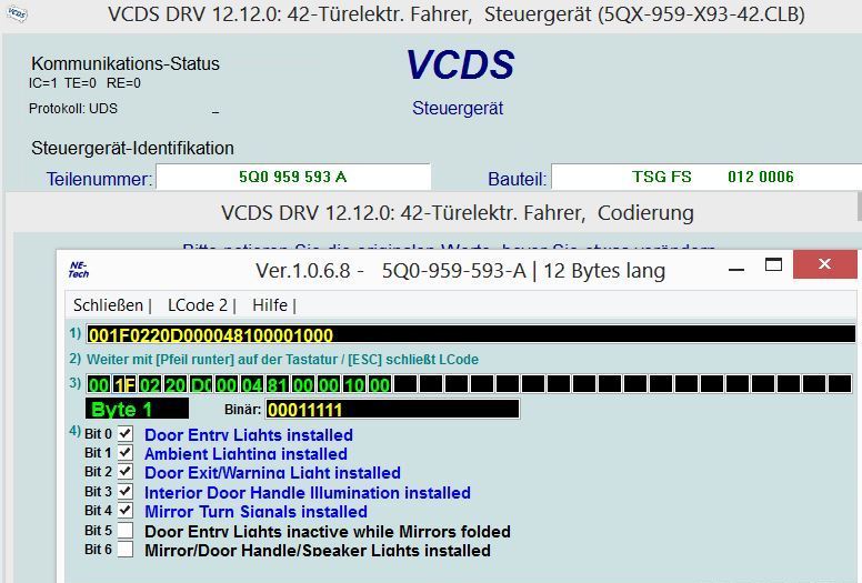

11. Puddle lights on while mirrors are folding
Can be found in the Door control module [42], Byte 1, Bit 5 (untick)
