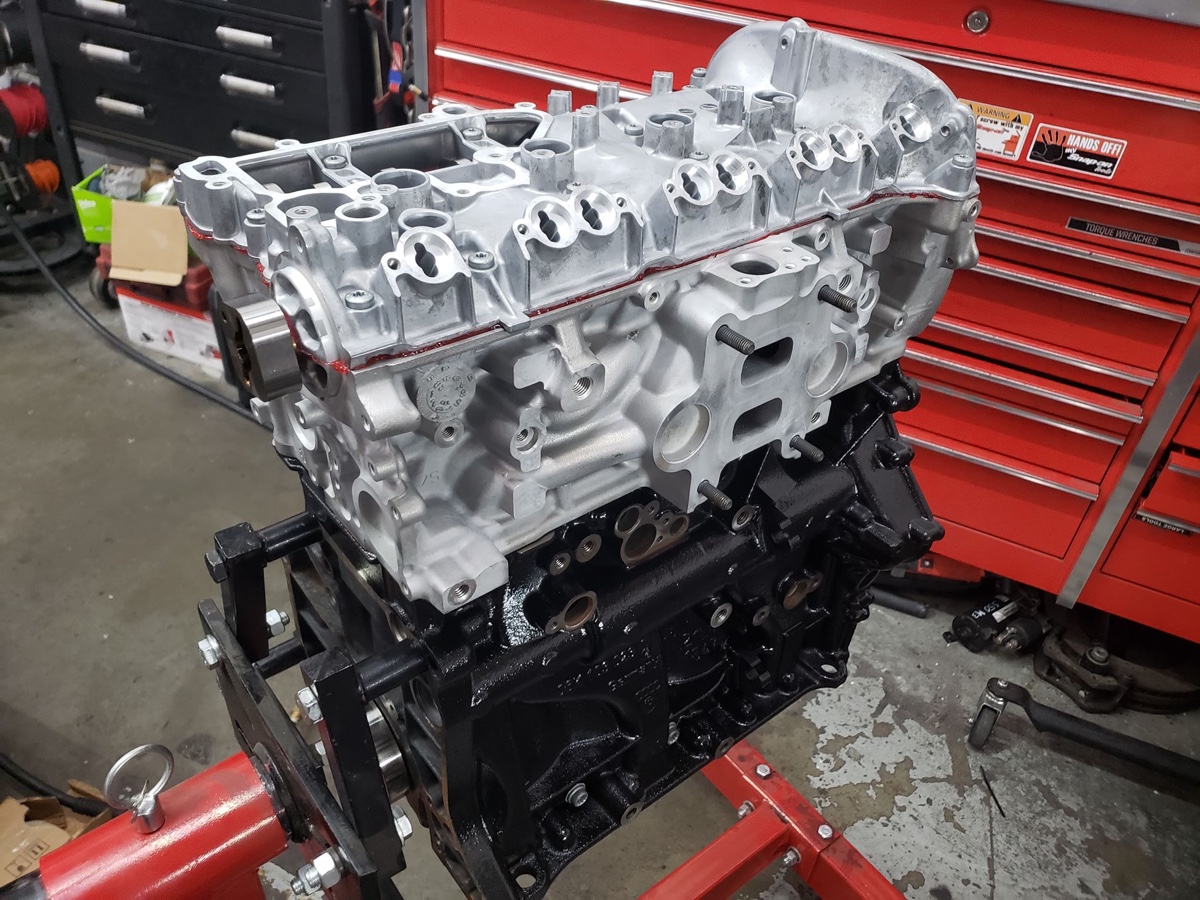

Full Integrated Engineering Long Block Crate Engine (First Engine Crank-walked)
-IE Tuscan I beam connecting rods
-IE Spec Mahle 83mm bore 9.3:1 forged pistons
-Mahle race rod bearings
-OEM new main bolts & thrust washers
-OEM new main bearings
-IE Valve Springs and Retainers
-IE Valve Guides
-Ferrea Valves
-IE Valve Seals
-IE Valve Keepers
-Performance Valve Job
Engine Installed and Assembled by Jerick Javier at JMP Autowerkz in Canoga Park, Ca

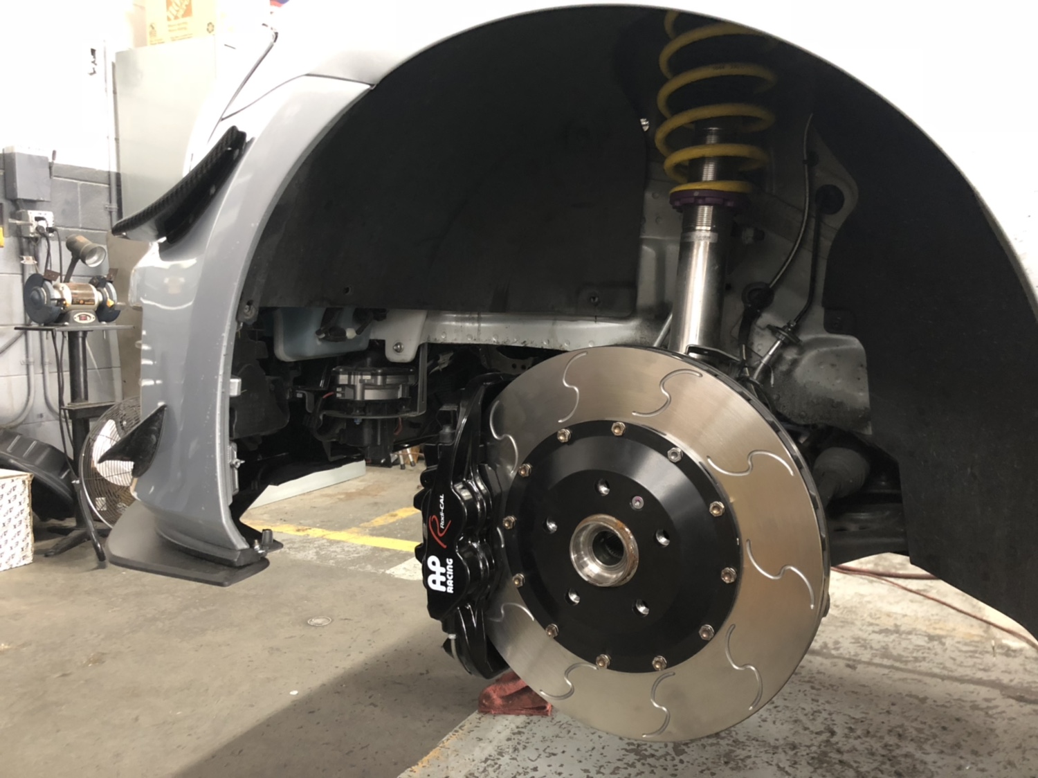

Front: Custom AP Racing Radi-CAL BBK Front 4-Piston / Chicane Pattern https://www.stillen.com/catalog/pro...ke-kit-red-calipers-apr34410sr/category/1594/

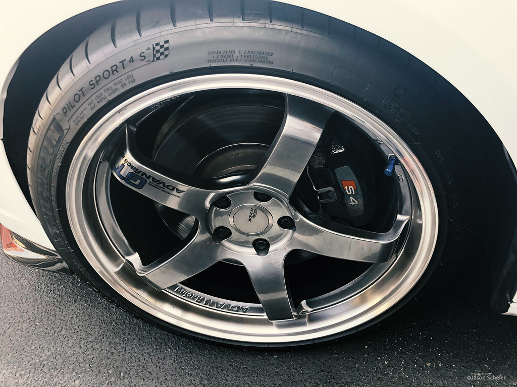

In case some of you guys are interested, here are some pictures of my Audi S4 B8 build.
ECS Tuning Aero: European RS4 front grille and Fog lights, Front Splitter, Rear Diffuser, Carbon Rear Duck bill wing. APR Stage 2 Tune, APR Crank and Supercharger Pulley, Advan GT 19x9.5+40 offset custom wheels, JRZ RS One Suspension, ECS Tuning Cold Air Carbon Intake, Michelin Pilot Sport PS4 Tires, AWE Track Edition Exhaust, AMS Front Mounted Intercooler, APR DSG Tune, Ultracharger, Mishimoto Oil Cooler, and many more.

For now here is a close-up on my 19x9.5 +40 Advan GT (Hyper Racing Black), going to get the Voomeran Over-Fender Flare kit to fit these on my GTI.

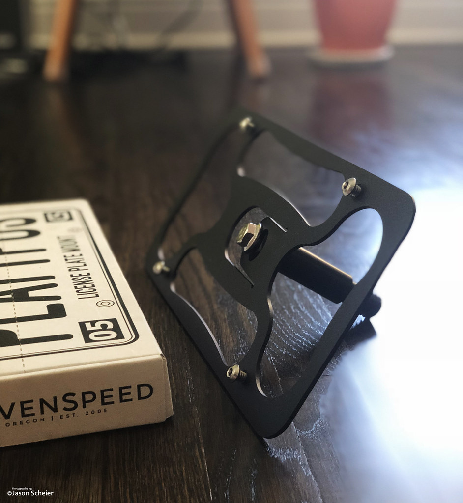

quick update: I received my Flow Designs front Splitter and Craven-speed front license plate relocater this weekend! I'll be sharing the splitter once it's mounted on. The license plate holder is a beautiful construction.

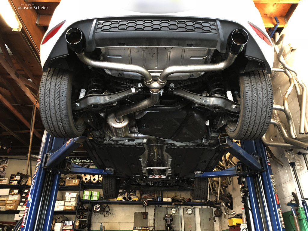

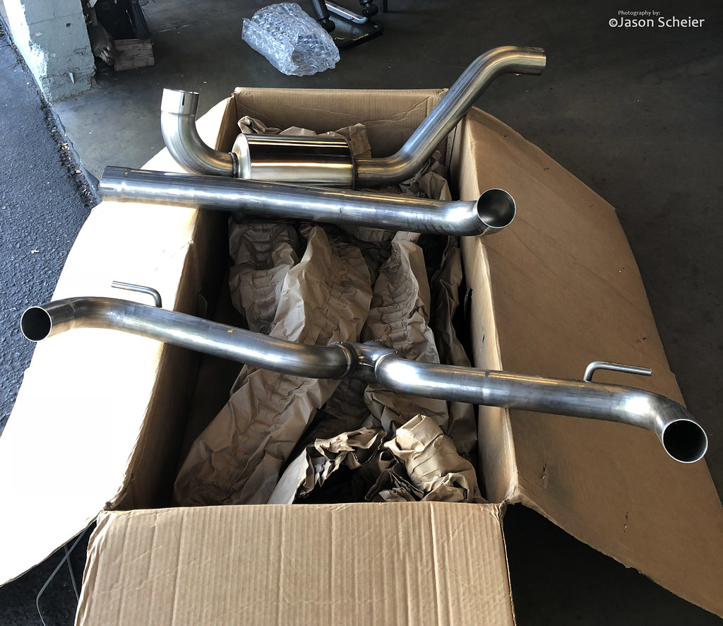

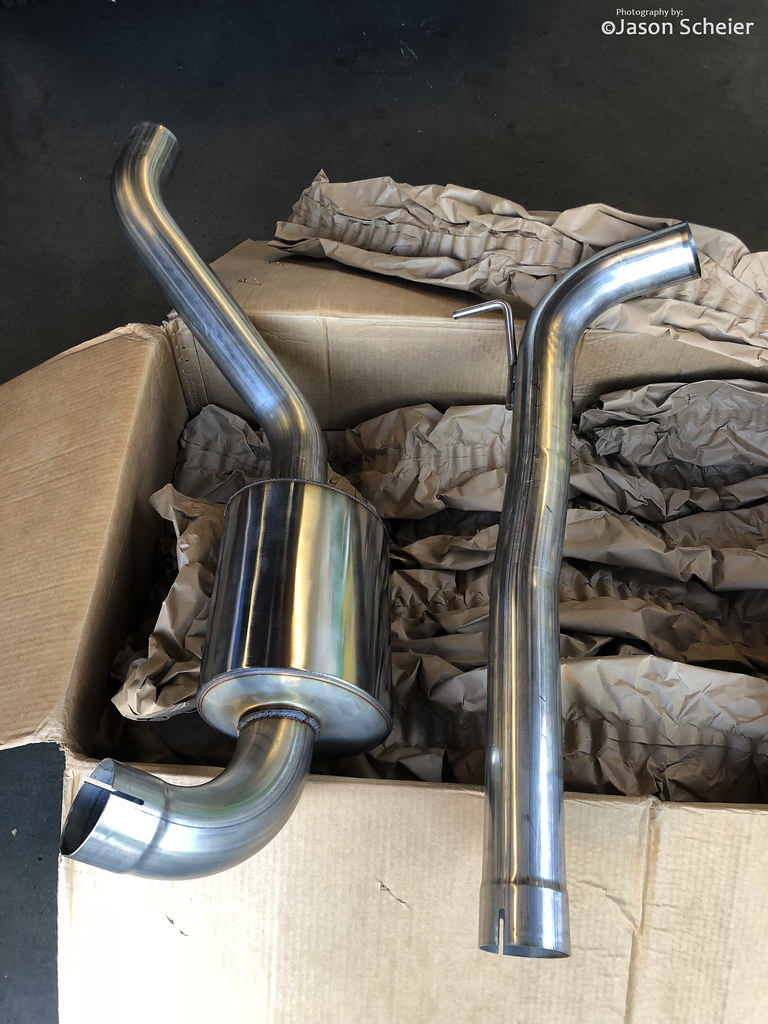

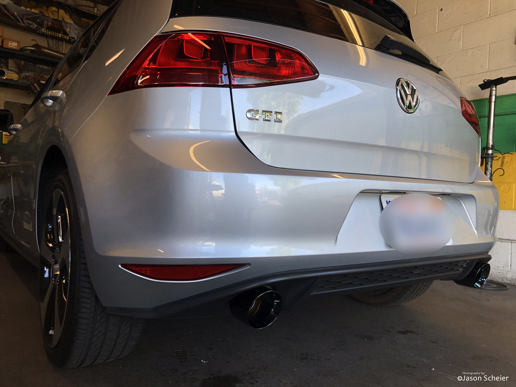

Just finished installing the AWE Tuning Track Edition Exhaust with Black tips. I'm really happy with the finish quality and performance. If anyone is interested, I'll post some sound clips. It's not droning or loud to be honest. Very happy indeed!
I'm thinking about going w the same exhaust (w AWEs DP)! Let us know how you like it as it breaks in. Great build so far.
Sent from my Pixel 2 XL using Tapatalk
It's been a full weekend of driving the GTI and I'm very happy with the performance from the AWE track edition exhaust. It sounds better and better as I drive and break it in. I love the idea of adding a catted downpipe as well. I'm thinking of going Cobb for mine. Keep me posted on your build bro! Thanks for the kind message ;)
