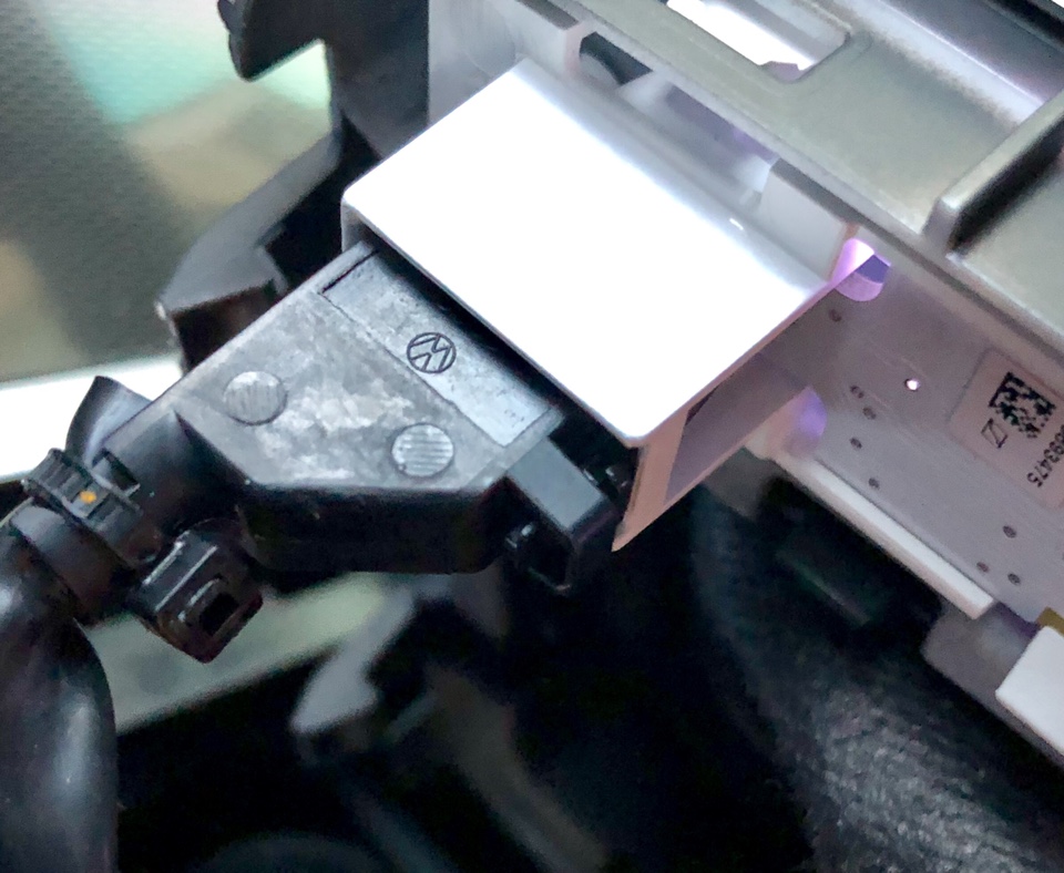

Unclip electrical plug and slowly pull out.

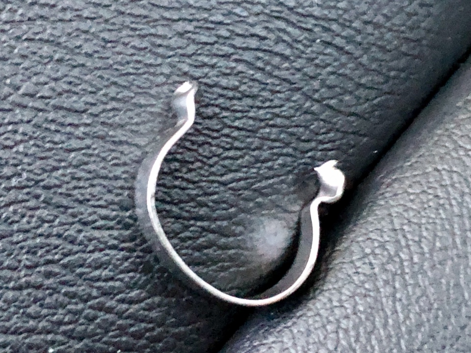

Now the metal clamp is cut. I cut at the tightening location. Easy to reach. Get a good hold and clamp hard to cut.
Pull clamp off.

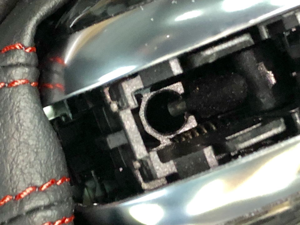

Clubsport in the install position. Trigger out.
Clubsport shifter sitting on top. About to push down in place lightly.
After Clubsport trigger pushed in.
Before you pull trigger make sure shifter down. Should feel solid with no rotation. Pin should look like it will slide in once you pull trigger.

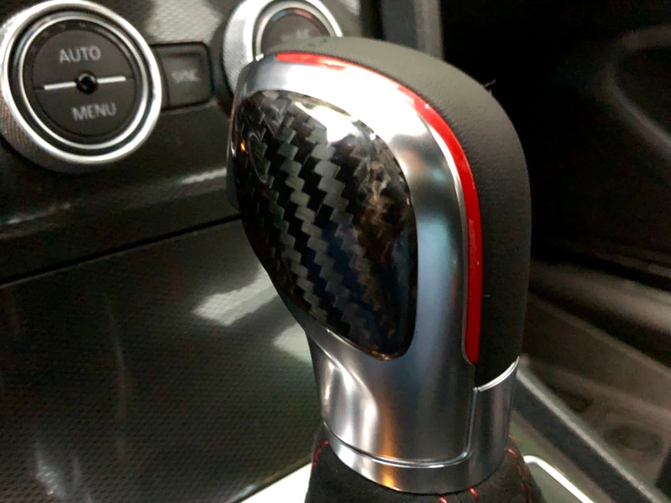

Now Enjoy as it looks great.

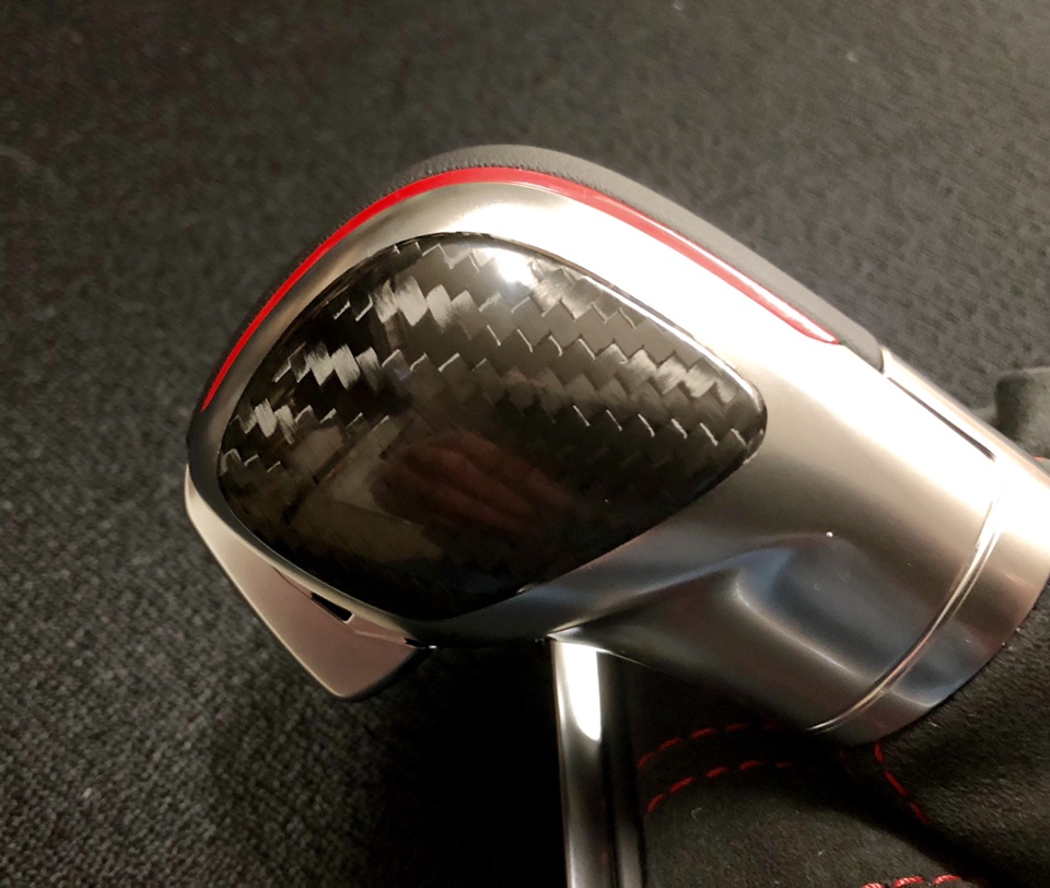

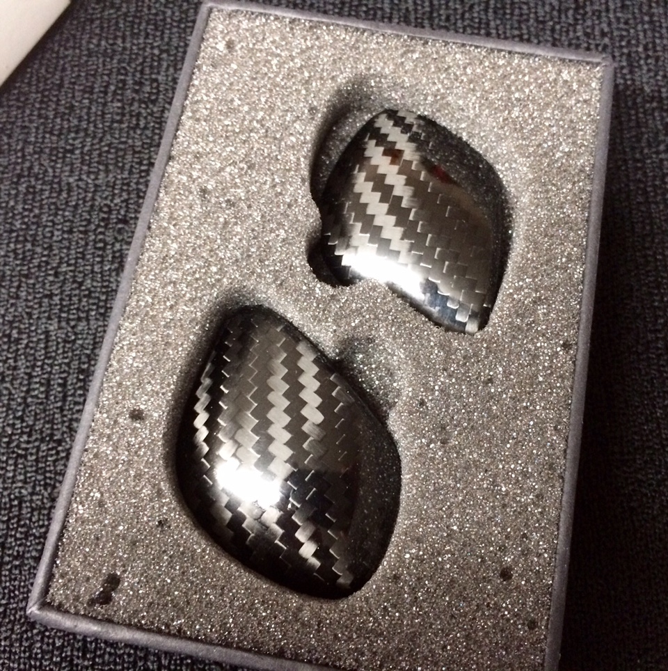

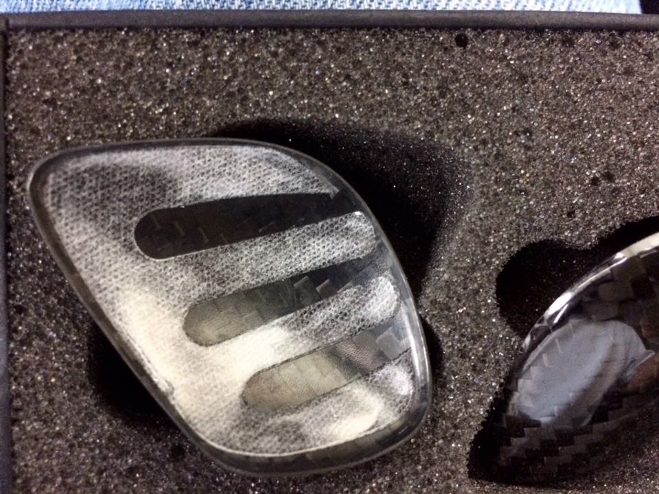

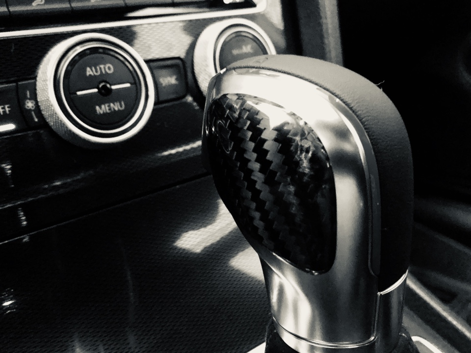

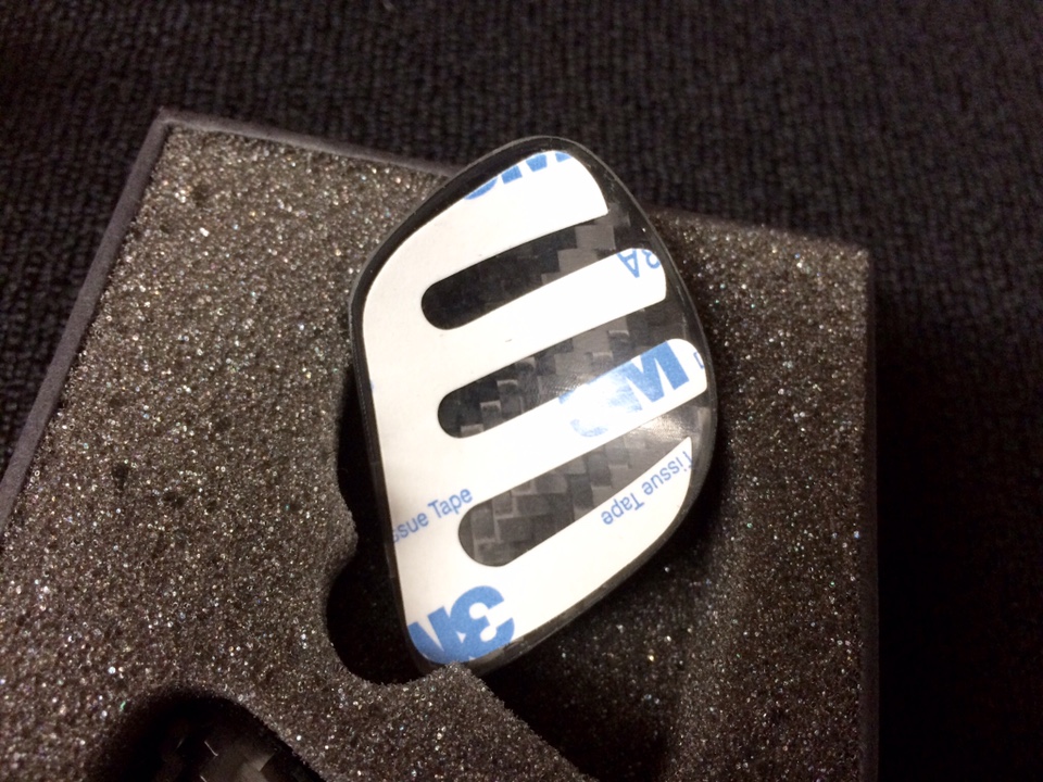

The design is better than USA OE piece. I had the carbon fiber side pieces on my OE stick. So I ordered a new set for the Clubsport. Added them prior to install, as it was easier to do in garage. Ordered from Aliexpress. Just search MK7 DSG Carbon Fiber. Fit perfect like the first set. Use micro 3M tape which comes on parts. Lightly put in place. Check alignment and slowly push down adjusting as needed. Very well made. I like the look and extra thickness. The Clubsport has leather sides like my Autobahn had. FYI.
Might be favorite mod but has some other competition!

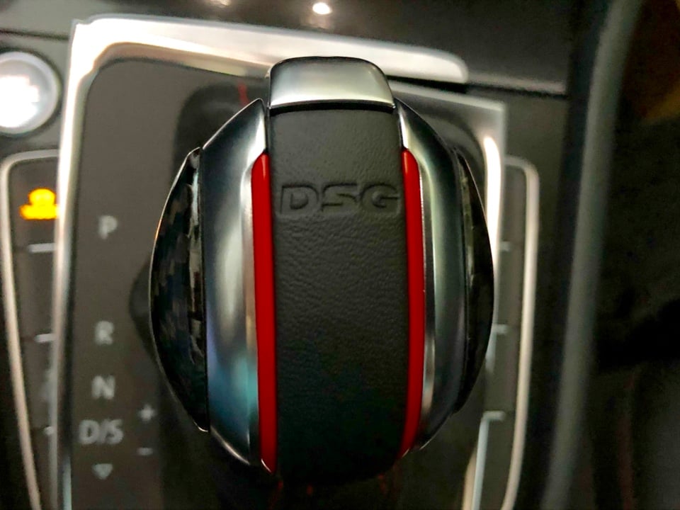

Maybe I'm missing something, but is the only difference the two red stripes?
sandmangti
Great write up as always sandman.
Alcantara leather boot.
Red stripes.
Metal strips on top are smaller due to added stripes. So cosmetic.
The shift button on front feels like it is out more. It is correctly in place and working but feels a little taller. Not much but a little.
First picture is from Internet. Show the boot. Dark here now so I cannot get a good picture. You can see part of the Clubsport seats also.
My OE shifter and pics of CF pieces if some have never seen. Located in my build thread also. Cost on Ali-express around $20. Good price for quality part. 100% carbon fiber. Wafer thin.
