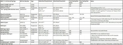

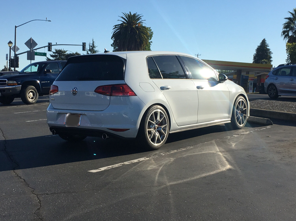

PS The stance on the ED Golf R springs was pretty solid:
rosebowl2 by Jon Collier, on Flickr
I just wonder if the trading some comfort going to Koni Sports over B8s with something like a Neuspeed or ED spring would avoid the front bottoming out. Not from personal experience, but from your experience it seems that Koni's on full soft are still a bit more "sporty" than the B8s. Sort of stealing from Paul to pay Peter if COMFORT is priority one.
