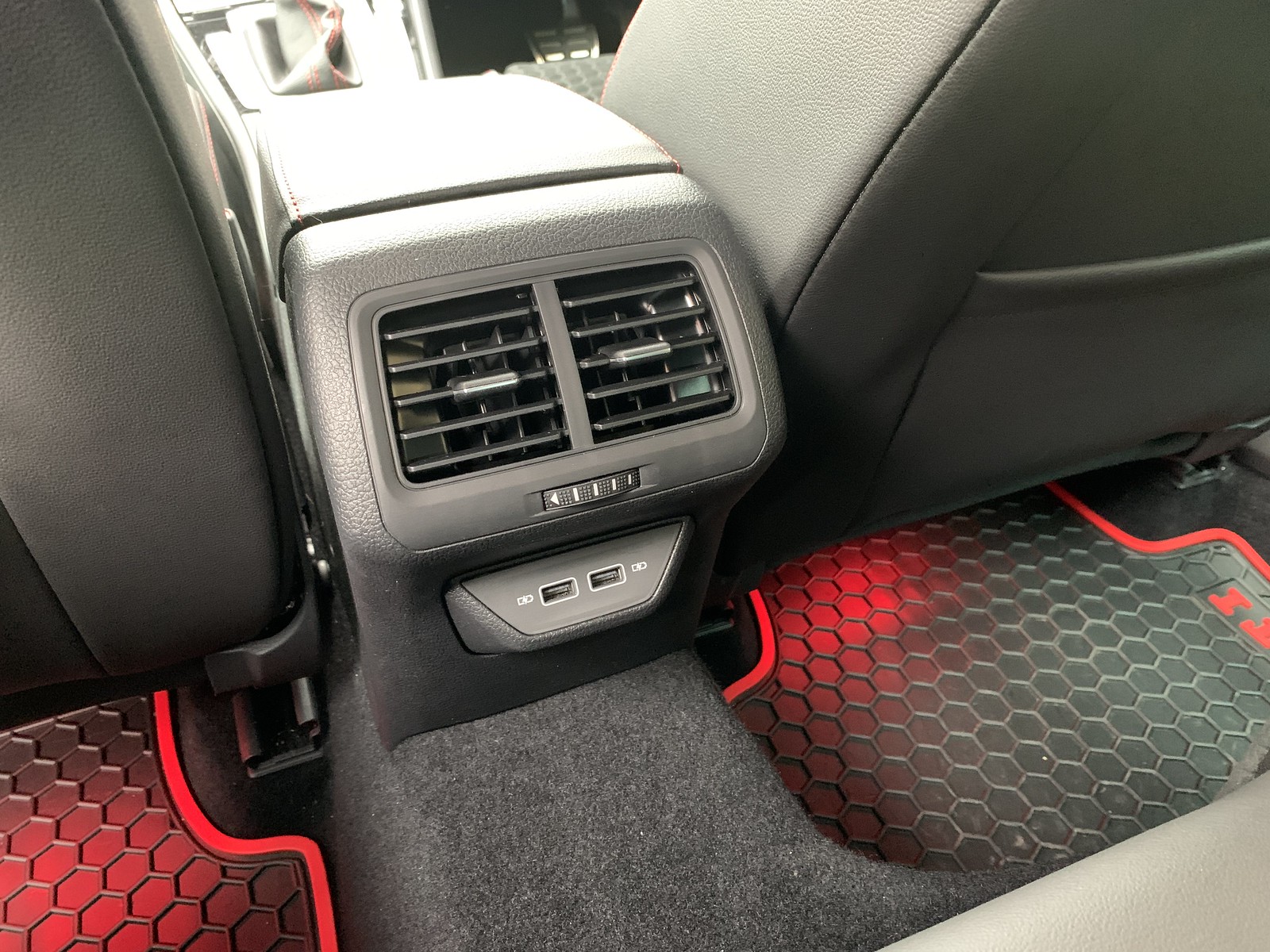

So, has anyone installed this? Also, could one rewire the harness that comes with it to piggyback on the outlet in the console?
I'm assuming the pictured unit is more favorable for the Golfs with armrest console access, as this unit looks like it would cover the console compartment opening.
Even if nobody has, I'm going to order it in the next 2 weeks and give some feedback. It would just be nice to know the fit & finish ahead of time.

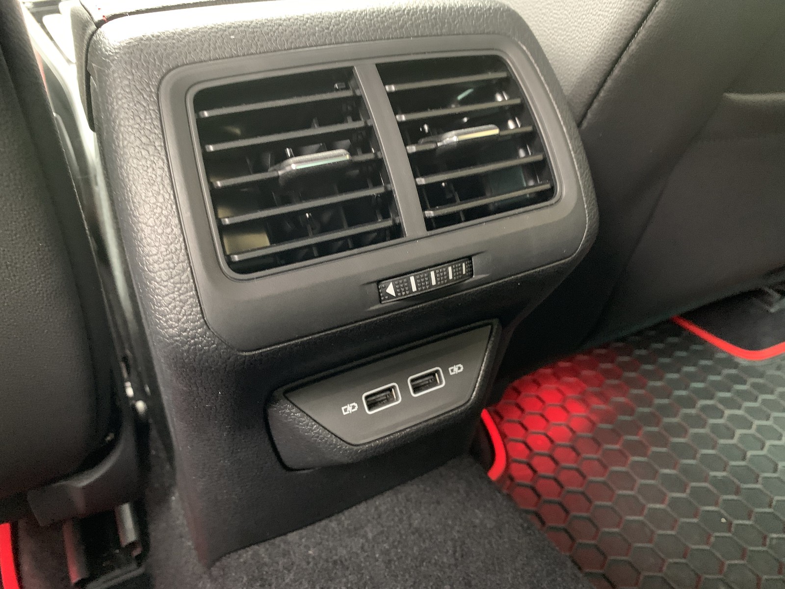

I just got mine from AliExpress and the fit / finish is amazing, except the retention clips are different from my 2016 MK7 GTI. I can post up some pictures later

Here are my side-by-side photos with the differences outlined. I have the the '16 GTI center console which does not have the drink cover and has a manual e-brake. I believe that's the main reason that it doesn't fit properly. I might be able to modify the tabs to make it work, but not sure it will be secure enough.
Let me know if you guys have any questions or want any specific photos.

I did it to my UK 2018 GTI, and it fitted no problem, but then we have the high line centre console and e-handbrake here in the UK

I just attempted to install this from AliExpress and it appears to be a 100% OEM part (box, cables, stamping, etc) BUT I am not getting any power to the rear USB ports.
I had to modify the wiring harness as there was a plastic guide that did not line up with the connector on the USB port so I'm suspicious of the USB port or wiring harness parts as being incorrect. The factory 12V still functions without issue.
I depinned the plug that goes to the USB ports and do get +5 and GND on them.
Did you need to do any modifications Sootchucker? What color was the plug that goes into the USB ports?
