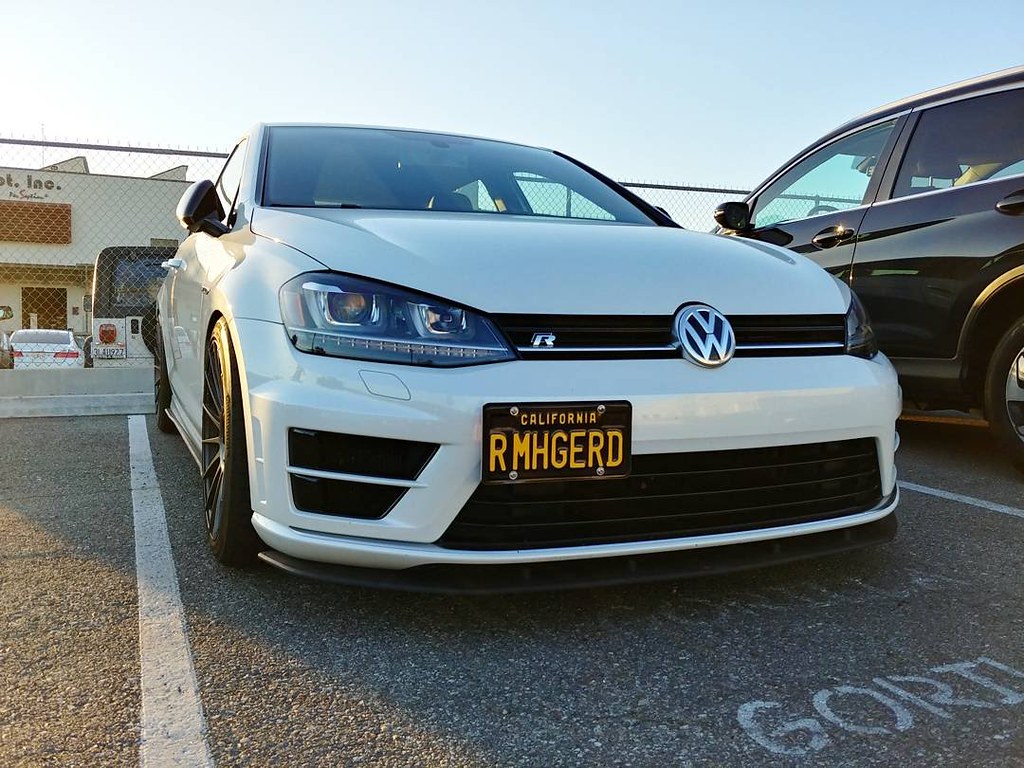

Okay, help me out here. I am currently running 18x8 ET 40 up front with 235/40/18 Conti ECS. F to G on front is measured at 25.125 (lowered about 1.125" on APR springs. Do you think I can get away with running a 245/40/18 tire? When I first installed my current setup I rubbed only on the biggest bumps. Did fender screw mod and haven't rubbed since. I'd like to go up to a 245 tire for AutoX but not sure if I can swing it.
Pics for reference.
